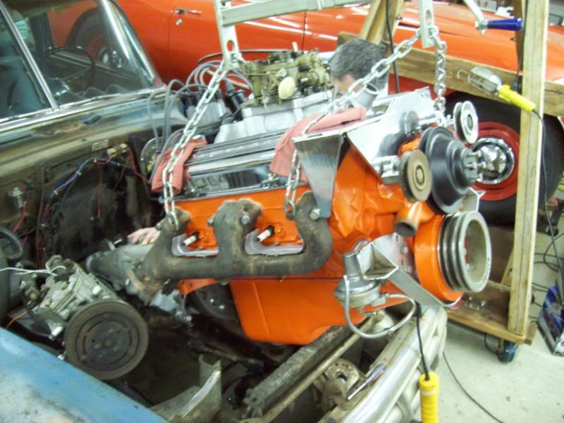

        This is the one. My very first car and daily driver for over 50yrs.
        The brand new 383, built from a small journal 327 with the crankcase vent hole in the rear.
        This shows how I plumbed the PCV valve---------------super simple. The inlet for the crankcase is an oil filler tube up front with a vented oil fill cap.
