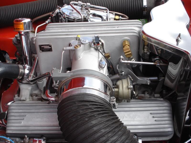

                        I also read Joe's article, and then sent him an email regarding similar engines I have built. As Duke refers to "cheater" engines, my favorite small block build is a SB400. With a stock GM 400 block, they CAN BE taken up to 434ci, but that sure pushes the envelope! I prefer to limit the displacement of a stock GM 400 block to 420ci. Also, they can quite successfully be take to 427, although, this requires a VERY short piston with a short skirt--------------------AND---------------the wrist pin is in the oil ring groove, which I personally do not like (I suppose that is just me)!
                        The engine in my 56, with a Bill Thomas modified FI unit, is a .030 over 400 with the longer 350 rods. A very straight forward build with no issues. In an effort to retain a pseudo 57 283 FI appearance, I used 66 462 heads with the double humps ground off and pyramid symbols shaped on the ends, ala 57 539 heads. Then I had extra bosses welded, drilled and tapped so that I could install 9-fin staggered bolt pattern valve covers. I drilled a hole from the rear of the block into the lifter valley and fabricated plumbing for a PCV valve. Thus, NO HOLES in the valve covers. Since 400s as well as 383s require a 400 style balancer and flywheel, I use a finned 327 balancer and a 454 flywheel with appropriate balancing.
                            Hi Tom:
                            That 400 looks terrific. Have you ever taken an unsuspecting Corvette guy for a ride in your "283" Fuelie? Did they think it was the strongest "283" that they ever experienced?
                            • Tom P.
                              • April 1, 1980
                              • 1814
                              Re: Joe Randolph's stroker article in the most recent Corvette Restorer
                              Originally posted by Joe Randolph (37610)
                              Hi Tom:
                              Yes, frequently, and I seriously flog it at every opportunity.
