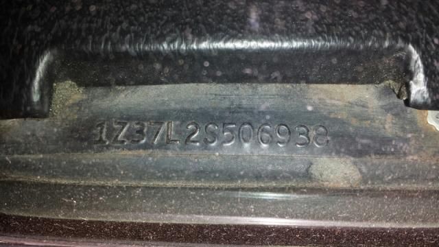

                            Hi,
                            Came upon this picture today and remembered this thread.
                            It's NOT a 69 however, it's a 72.
                            If only he'd moved a bit to the right.

                              Thanks Alan, appreciate you thinking of me!
