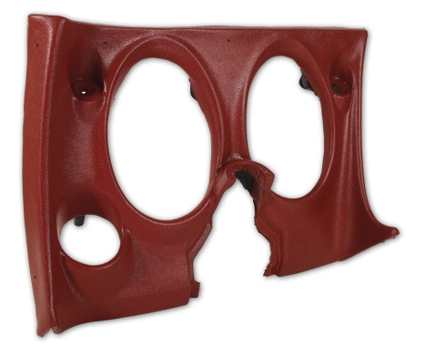

    EC Products?
    Corvette Pad Dash Lower Left 68 / 1968-1968 / ( #E6394 ) SHOWN IN 1968 DARK ORANGE LOWER LEFT HAND DASH PAD WITH OUT AIR CONDITIONING COMPLETE WITH ALL MOUNTING BRACKETS AND CLIPS ATTACHED. BELOW, NEXT TO "OPTIONS", CLICK ON ARROW TO VIEW COLOR SELECTIONS.
