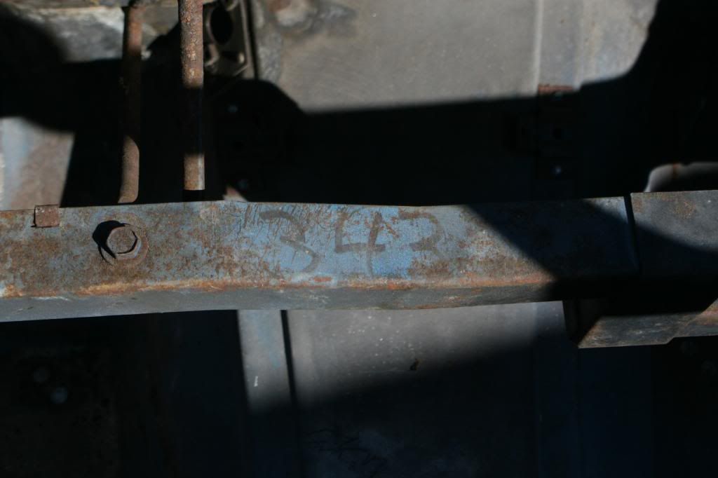

            It would be interesting to know what the body marks are on both bodies. It would tell more about the build sequence.
            • Daniel J.
              • July 29, 2007
              • 158
              Re: C2 - 1966 Trim tag - body sequence number question
              Wayne: I am unsure of what "body marks" you are talking about?
              • Wayne W.
                • April 30, 1982
                • 3605
                http://forums.corvetteforum.com/members/19662005-365044-albums-mike-s-66-coupe-25715-picture-b137-on-underside-of-passenger-side-foolwell-bulkhead-area-109630.jpg
