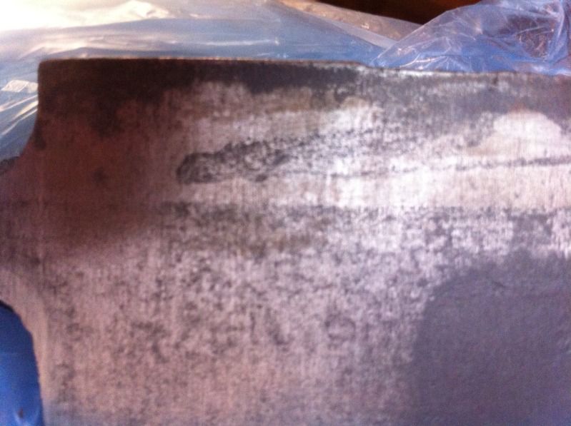

            #35
            Re: 65 396 Engine Pad Opinion
            How do these broach marks look?
            This is a May 1965 962 block.
            G.
            • Patrick B.
              • August 31, 1985
              • 1995
              #36
              G.
              It looks like an over-the-counter never stamped block. Is there a stamping on the oil pan surface at the rear of the block (I think on the starter side) that looks like a Tonawanda pad stamp lacking the HP code -Txxx or Txxxx? Is the casting date E-26-5 by any chance?
              • George W.
                • May 31, 2000
                • 544
                #37
                It is dated E 26 5 and has the stamping (see below) on the starter side of the oil pan surface----How did you know this?
                I did think that this looked like an original un-stamped block that must have been sold over the counter.
                It's actually a complete short block assembly (fresh rebuild), that is bored .100 over.
                I took it apart and had the block sonic tested; machine shop said there was still "plenty" of wall thickness (don't remember the numbers, but I have the test report out in the shop). I guess these early 962's had a lot of iron?
                Are the production blocks void of the stamping in photo below?

                      #40
                      George: I have an unstamped 65 396 block also. It was the only one I had ever seen until I saw your pictures. It is also dated E-26-5 so I just guessed that maybe they cast some extras that day for warrantee work. Every never-stamped big block I have seen (66's and 67's are more common) had the Tonawanda machining date stamped on the oil pan surface. I think your stamping means August 5. Mine had a maching date in July.
                      1965-only 396's used the same water jacket molds as a 427. You can see this is true by comparing the space between the cylinders inside the water jacket with the freeze plugs removed. One of these blocks can usually be bored to 427 + 0.100 so 396 + 0.100 is nothing. But do not try a big bore with a 66 or newer 396.

                        #41
                        Patrick,
                        Thank you for the information.
                        Very glad to to have affirmation regarding the .100 over bore.
                        I'm confused on one statement: "Mine had a matching date in July". Matching to what?
                        G.
                        • Patrick B.
                          • August 31, 1985
                          • 1995
                          #42
                          Patrick,
                          G.
                          Sorry for the typo. I meant a machining date when the casting was finished as a block.
