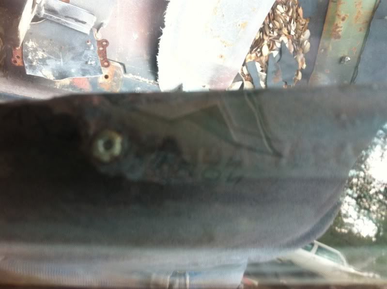

    Windshield pillar post rust has eaten into the VIN tag.
    I am going to repair/replace the birdcage rusted areas on this '68 (real 900 paint code, 427/435 conv.).
    Do I need DMV to verify before removal and re-install of tag?
    Ideas, comments, suggestions, previous history with this problem, please chime in.
    Thank you,
    George

      Thanks for your response.
      Sorry for the lousy photo--I'll try again.
      All of the numbers are there on the VIN tag, both original rivets are in place, but the lower part of the tag is partially rusted away.
      I don't think I need a new tag, but I want to remove this one and re-install it once the rust damage is repaired/replaced.
      G.

          Well that shouldn’t be a problem, just be sure that you try and not damage it any more than it already is when you remove it. Then paint it with a good rust preventive paint. And get the correct rivets and put it back on the car.

            In most states it is not illegal to remove a VIN tag on a car that you own or are under contract to repair. After all, you own that number and can do what you want with the vehicle. I assume that the title is clear and the car has not been stolen or salvaged. I'm sure removing the tag is not an issue in Texas. If you are concerned, take some better pictures and document the process.
            As for replacing the tag, once again you own that number and you are not changing it. I understand that there are people who can make a new tag for you, but I don't know who these are.
            Terry is correct about DMV. Stay away from them unless you want your car to carry a stigma that will effect the resale value. They can do nothing more than issue a new VIN, which will not match the original. However, they may do nothing since the car already has a valid VIN, it's just not properly displayed (eaten up by rust). Don't forget that they don't know anything about automotive restoration and could care less.
            There are many examples of people removing VIN's, the most recent that I have seen was on the TV show MuscleCar, where they removed the tag on a 70 Camaro for the exact same reason your talking about. They are in Tennessee.

                You will have to make your own decision, but here is what I did when I had to replace a rusty top dash panel on my 68 Camaro. I carefully drove the pins out of the rosette rivets, lightly squeezed the bulb end of the rivets and worked them out without damaging them. After I replaced the dash panel, I reinstalled the rivets using pins from a regular pop rivet and gently pulled them again slightly expanding the backside of the rivet. You would have to have the windshield out for access.

                    I would not chance a repro VIN tag. If you get caught by DMV, you are in deeper doo doo than you could ever dig your way out of. If it is detected on the judging field, the car will automatically be disqualified from judging and will be listed in the database as such.
                    Just very carefully remove your old tag and reuse. I like the idea of using the old rivets.
