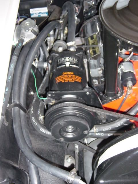

                          • Mike G.
                            • January 1, 1991
                            • 418
                            Re: 1964 Heater hose crimped at AC compressor
                            FWIW, here's my '65 L75. You can see how nice the lower heater hose bends when the clip is where it should be.
                            (the hood is off for a respray, which made this view a bit easier)
