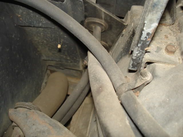

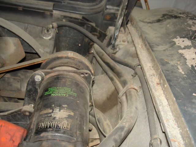

                OK, Here goes. This is my original SB AC Auto, AOS car , about 13500 ish serial number. Interesting thing is that it has the one forward clamp and has bolts installed at the lower rear position but no clamp. Don't know if that is an AOS thing or not.

                  Scott, Unless my eyes are deceiving me I see one bracket for the heater hoses(UPC C60 Sheet D3) and two brackets for the refrigerant hoses(UPC C60 Sheet D7). Take a look and tell me what you see. If the contention is that the actual assembly varied from the AIM specifications by eliminating one of the brackets then that is whole other issue.

                    I see the Heater Hose clip (GM 3841336) on C60-D3. That is the one that was moved 2" closer to the front of the car beginning with the 1966 AIM, presumably due to the indentations molded into the RH inner fender skirt making it impossible to bolt the hose clip where it was attached in 1964-1965. If I understand correctly, this is the Hose clip that is missing on Wayne's car, but his car does have the item 6 (GM 120706) bolt occupying the lower hose clip attachment hole.
                    On C60-D7 there are indeed two GM 3841336 hose clips shown in the main drawing, both labeled item "1". There is a "close-up" arrow pointing to the area that is labeled "A-E". I understood this to mean that, although both Hose clips are shown in the main drawing, it is an "either / or" situation, depending on whether the engine is SB or BB. If SB, then "View A" would apply (bottom RH corner), and if BB then "View E" would apply (upper RH corner), but not BOTH.
                    The curious thing is that the drawing of the forward-most hose clip (closest to the front of the car, appears to be parallel to the mid-point of the A6 compressor) is depicted in the exact same place for 1964-1965 small block in their respective AIMs, BUT, according to the 1966-1967 AIMs, C60-D7, "View E" ("Existing Dimples, Forward Set"), that Hose clip location has been re-assigned for use with RPO L36, and a "new" Hose clip closer to the firewall has been added (1966-67 AIMs) for the Small Block car, detailed in "View A", "Existing Dimples, Rearward Set".
                    Wayne's '67 small block appears to have the Refrigerant Hose Clip at the "Existing Dimples, Forward Set" big block location (parallel with the middle of the A6 compressor), and no Heater Hose clip at all. My GUESS at this point is, that the lower set of hoses (heater hoses) are being forced against RH inner fender skirt anyway, because of the way they are oriented (bending) and where they terminate, so with the new-for-1966 and 1967 indentations to "seat" the hoses against the RH inner fender, the Hose clip was no longer necessary.
                    If this is correct, then the 67JG is wrong, it should say that ONE Hose clip is used for the Refrigerant Hoses (and explain the difference, if any, in location for SB & BB Hose clips in actual practice), and confirm that there is NO Hose clip used for the lower set of hoses (the Heater Hoses).
                    That is my current understanding, based on the available evidence and Wayne's most recent pictures.

                        Thank you for the photos. Are the lower hoses (heater hoses) simply forced outward against the RH inner fender, "seated" into the indentations that were molded into the RH inner fender for 1966-67, making the hose clip at that location unnecessary?

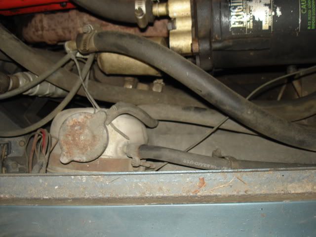

                        In an unrelated question, should the expansion tank balance hose be routed outboard of the hood support? It was my understanding that all of the GM 3825551 push-in tie straps should be oriented with the loop upward, which would route the hose to the outside of the hood support, as claimed on p. 131 of the '67JG.

                          On mine there is no clip on the heater hose, but there are bolts in the holes for the clip. Whether it ever was there or not, I cant say for sure. I will look closer on the underside for evidence. The routing on the upper hose could have been changed. This car did have one of the infamous BB hoods installed at one time, so that is likely.

                            Regarding your expansion tank balance hose routing question, how do you interpret UPC 11-13 A4? The first 2 strap loops, closest to the firewall, appear orientated down. The 3rd loop, cosest to the radiator, appearsorientated up. And, the hood support is not shown. It does look like the hose bends upward before turning to the radiator which would cause me to conclude that it goes on the outward side of the hood support. If wayne were to reorientate his first 2 stra loops down and the last one up and route the hose behind the hood support I think it would look just like the AIM drawing on UPC 11-13 A4.

                              I am betting all were up. If you turned them down it would interfere with the AC bracket and hose and there would be a significant upward curve on the radiator end. Up is a much neater application.

                                I can see that by looking at your Photos again. Do you agree that the hose should go outward of the hood support?
