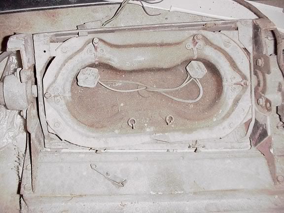

    Here's a pic of one of mine from my car which is a little before 11,000. They are marked L & R. One worthy note was that the bulb holders have the round center, as opposed to the 64-7 square versions, and they were also Gold Cadmium plated. I found the bulb holders at Ecklers Late Great Chevy, for they are the same configuration as the full size models, but the one's at Ecklers are not Cad plated, they are black, and are the 2 screw type, with the third hole being for the little spring.

      That one is very similar to a pair of mine. No signs of the clips that go in the slots on the bezel ever having been there. One question: On the tabs at the top are the holes showing drilled where sheet metal screws could have been, or are those rivets securing the tabs? The ones that I have that have no signs of holes or tabs there have rivets securing the tab.

        They are rivets on mine, but it being a middle of the road car, I gotta believe there had to be variations on these just as there are on many other patrs of the car. Hopefully someone will chime in who has a car close to your serial number that can explain what's on his or hers.

            What's really odd about Gary's is that there are no provisions for upper screws, side OR front, and no clips either. I don't see anything to hold the bezell except the 2 brackets for screws in the bottom.

              Mine is the front screw version as shown in the attached pic. I remember reading somewhere they went to the side screws around 15 or 16,000. I have seen buckets over the years with the clips you speak of.

                        I can see how the bucket in post #10 above holds the bezel, with 2 screws at the bottom and the clips at the top, BUT I cannot figure how the bucket in post 2 holds the bezel with NOTHING at the top, assuming the 2 holes showing there are rivets holding the tabs, and only the bottom 2 screws. At least one of my buckets is in that configuration, and I think 2 of them are actually. I'll try and get some pictures tomorrow. Right now it's looking like there are at least 4 different configurations in the buckets and 3 in the bezels, in the case of the bezels 2 screws through the face at the top, 2 through the sides at the top, or none at the top.

                          The bucket in #2 has the two small holes at the top front. They are for the upper bezel screws. The two larger holes are to hold the light capsules.

                            Wayne, I'm not so sure about that. At least one of the ones I looked at yesterday, and I think a pair actually, had rivets in that position and no holes there. I THINK that's what we're seeing in picture 2 also.
