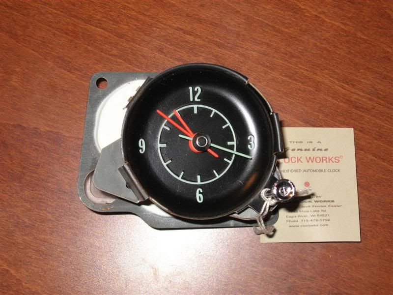

            I replaced the quartz clock in my 71 with one that had a NOS movement. I purchased it from the Clock Works and it's been working for the past 3 years without a problem. They can also restore your clock.
            The Clock Works is your full-time automotive clock service center! With over 20,000 units serviced, we are the first choice for automobile clock sales and service. No radios, no gauges, no speedometers, no tachometers... Just clocks done right!

              I had D&M redo my clock as original and it works great. Keeps time perfectly. They use brass gears in place of the plastic used by the GM contractor.

                My thanks to Gerard and Bob, Kevin of course; always a good source,for your input. The prices for Clock Works are very reasonable.
                I have a Q clock in the car now and wanted my original back. So, I did clip the spring, call it a britz if you will. It has been running on the bench for a whole day now and I think increasing the tension has helped.
                If it continues until tomorrow I will consider pulling the dash and putting it back when the weather improves.
