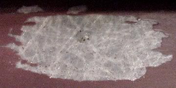

          Re: C2 Hood Ledge Bump?
          Here is one that has been stripped. I have never determined just what it was for, probably nothing. My best guess is that it is a hardness test of the mould. It is on all bodies even early 63s.
            Originally posted by Stan Emert (19259)
            Most have been sanded off during restoration.
            Or during assembly prior to paint....
              Think It Was Because Of A Flaw In The Mold For The Surround Panel . I Know This Was On St Louis Cars. Can't Remember For Sure On Ao Smith. ( Located In Front Of 13th Vent Grill Slot )
                Thanks, I will continue to look for A.O. Smith cars. Mine does not have it but it is on the second coat so it could have bee sanded of in Georgia. Looks like there could be a residual trace if it were sanded off.
                  Was on AOS too.
                    Found mine partially sanded off, April 66.
                      There wasn't one on my A. O. Smith '65 car before I restored it.
                        I looked at three original paint cars yesterday, 2 AOS and one STL body, all three had the bumps. I have never seen an original car that did not have one
                            John, if the bump was missing on any of the cars we restored, we added it back. It is not easy, but doable
                              Dick. Mine must have gotten sanded off along the way before I bought it 3 years ago.
