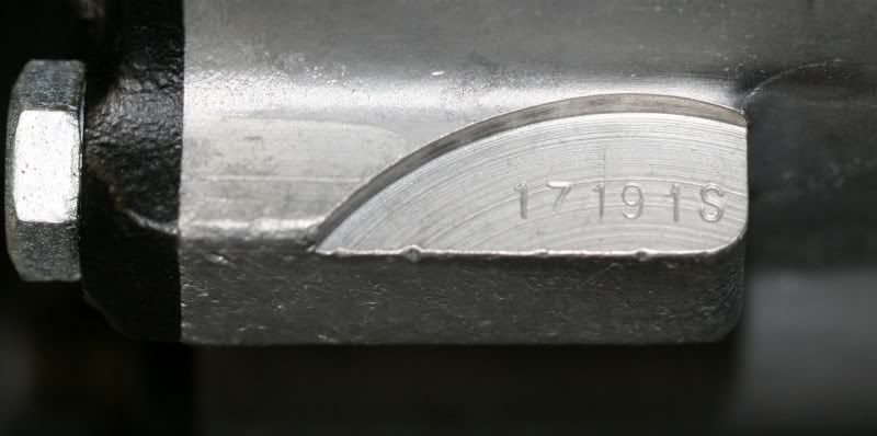

    Can someone post an example picture of the date code on a smog pump for this era? Thanks

    Here you go...
    The date code is stamped on the bottom of the pump when mounted. Judges will check the date with a mirror. This one reads 28091S. Which is a Julian date code for the 280th day of 1969, or October 7th 1969. It is on a November 20th Trim Tag car. The 1 is the shift number and the S is a broadcast code. </SPAN>

      Thanks. I'm trying to compare font and such with a pump I purchased.

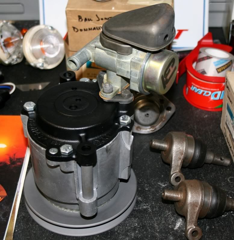

          I don't know for sure but I have been told that there is a difference in where this date is stamped. Like on my pump for a 68 its up on the boss and not down in the milled portion. Does anyone know about this minutiae? This is a Hodel pump.

            Dale, my original early 68 has it not on the boss area like your picture.
            Jack Corso

              I have judges quite a number of 1968s witht he date on the cast part of the housing. I believe that is common for that style of pump.

                Thanks for everyone's help. Please submit some more pictures if you like so I can check fonts.

                  This pump is from Bill Hodel...
