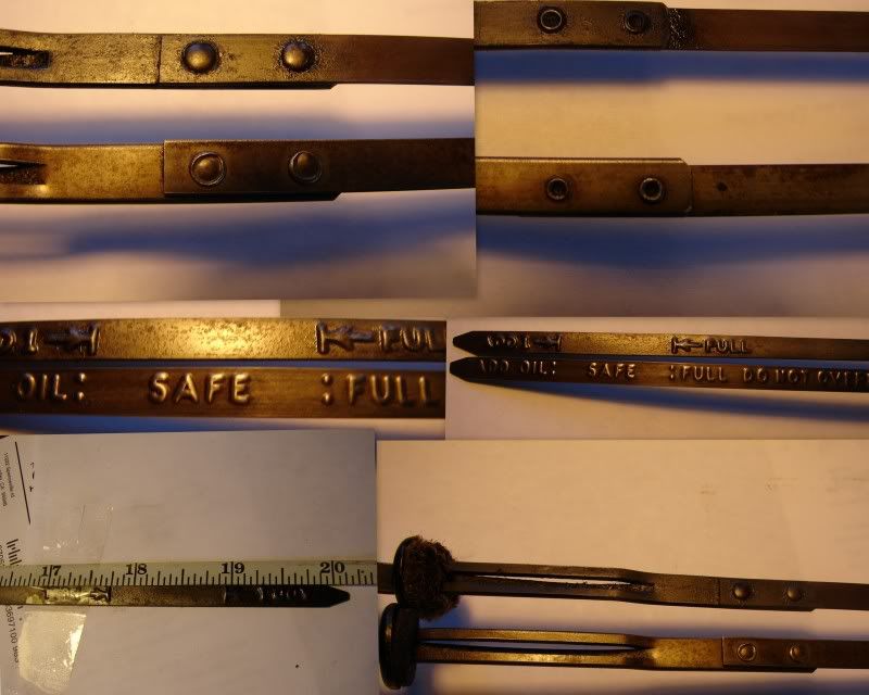

      Roy,
      What would you use...say you had a non-baffle oil pan?
      I have what I thought was the correct dip stick and tube for a "55" until
      I looked at the parts book.
      It shows:
      Length of tube.. 55 ALL (8cyl.) O.L 7 1/4"
      55 Corvette (8cyl.) O.L 7 1/16"
      Gauge Stick... 55 (8cyl.) ALL, Corvette single piece..
      From Stop to Add Mark... ( A )
      17 3/64"
      From Stop to Full Mark... (B)
      19 3/64"
      What I have is:
      Tube.. 6 5/16"
      Stick.. (A) 17 15/16"
      (B) 19 1/8"
      Measure is approx. correct.
      (B) would be correct
      (A) aprox. 3/4" + difference.
      Anybody have the measurements? Roy?
      I have a couple dated In-take Manifolds . Still trying to figure what build
      Dated numbers to use.
      Karl.

        I don't know about the book but the original oil stick showing arrows is original (first design)(at the ADD end is a number 1 meaning add one quart) the tube measures 6 1/4 and is curved . The second design between the low and high is the word (safe) and do not over fill . Both sticks have a W or M on them. (only a 55 stick will go down a 55 tube ) later year oil sticks will not fit (to wide) And the measurement is from the stick cap stop.
        Intake date is 6 months from build date (isn't that what the JM said)??? Vary early intakes don't have a date code!!!
        Did this HELP you??

          Roy,
          Thanks for the pictures.
          The Stick I have is one piece. The end is cut on a slant.
          I'll try to get a picture back to you if I can figure out how.
          I have Windows Vista now. should be called (Windows Miserable)
          The tube I have might be right. It's that length and curbed.
          Karl.

                                Thanks for posting pictures of the dip sticks.
