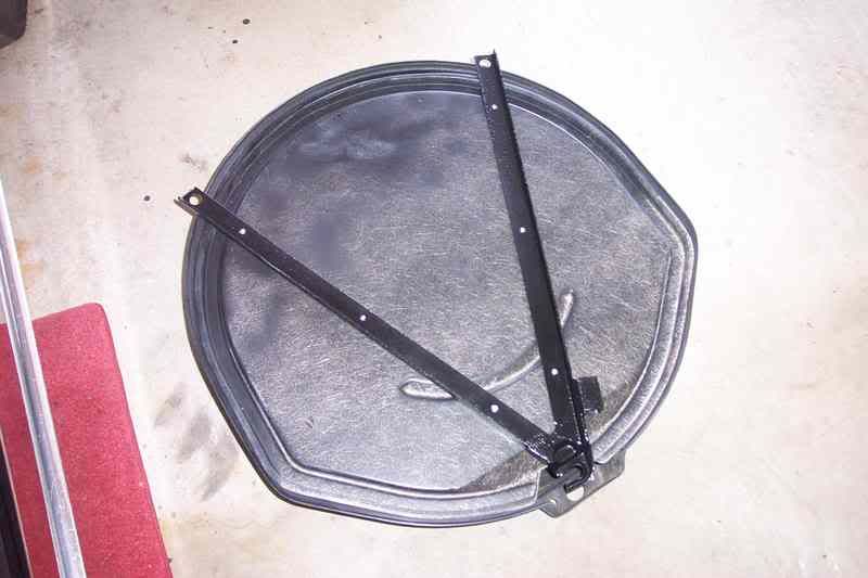

          JR and Tim:
          Here are some pix. Hope this shows what you're looking for.
          Chuck

            Thanks Chuck, Is this tub original to the car??

              Chuck,
              Thanks for the pics. That tub (fiberglass) is definately a 63 only tub and cover.
              Below are some pics of a 63 rear hanger. Original brackets were NOT plated as this one is. Only the bolt was plated originally. It was plated by accident.
              JR

                I was pretty sure it was the original. I would have had no reason to change it.
                I've seen that style of hanger. Mine has the more "standard" type, but it's a late car.
                Chuck

                    My tub "V" brackets are identical to Chuck's, but then why wouldn't they be as our cars practically held hands down the assembly line; mine on Tuesday morning of the 9th, and his probably on Thursday the 11th (19,147 vs. 19,496). The one thing we can have some solace in is that our cars were not Monday or Friday cars.
                    Not knowing any better, I squirted mine with some black undercoating paint back in 1976 and have yet to correct it. As I recall, I blacked out the exhaust system I had on the car at that time as well. That was common practice during the "rusty" 70's. I had a 72 Nova SS that practically disappeared before my eyes back then too.
