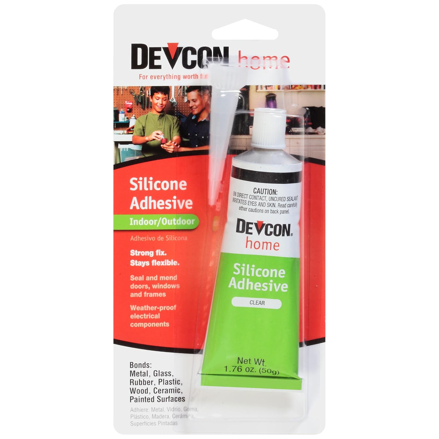

          Re: '63 Rubber Cushion on Crossmember Over Rear Axle
          Frank, this is the glue I'll be using....

            #50
            I'll go with that too I think...
            I need to have enough "set up" time to persuade those cushions to go into place with the body on the car so that limits what can be used...

                Did the "deed" this morning using the measurements above I settled on 10" both ways from the center of the big hole (per the mark on the tape in the picture) and used the adhesive Harry came up with and positioned the top of the cushions per his mark. I used a carpenter's square on the fiberglass ridge rearward of the crossmember to get the cushions squared up.
                I think the Doc Rebuild repros are spot on as one side took some coaxing to line up and the other was snug but slid into place...
                Then I laid my compact spare in the luggage compartment to keep weight on the cushions while the adhesive sets up - checked the cushions and the extra weight does make things snug while curing.

                      An FYI Harry - your adhesive worked perfectly...after 24 hour cure time and some weight on the cushions they aren't going anywhere. I cleaned the top of the crossmember with Simple Green thoroughly before installing the cushions....
