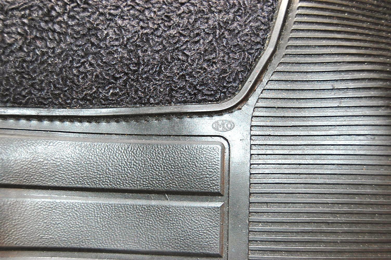

          Hi Reba,
          The IMCO logo on the original heel pad is 9/32" long.
          The IMCO logo on the Romeo pad heel pad is 15/32" long.
          The Romeo pad.

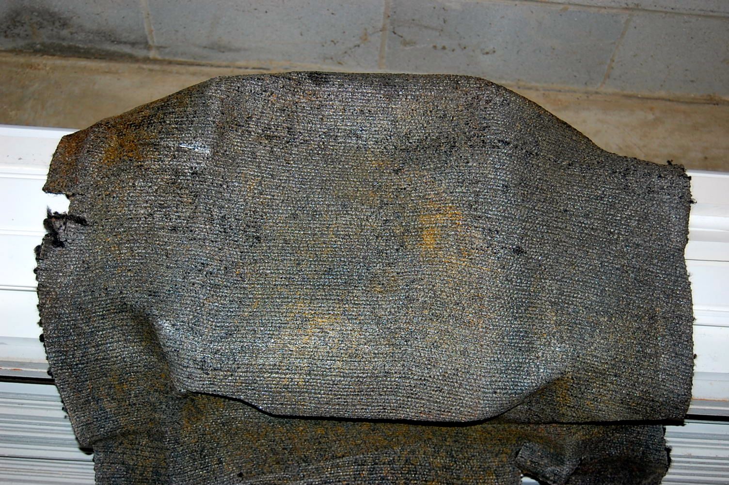

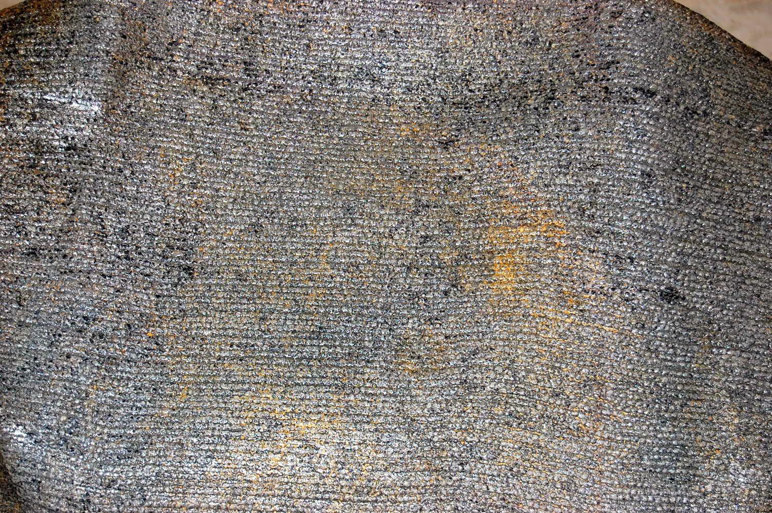

            Hi,
            Here'a a couple of pictures of the corn 'rows' on my 71 std. 80/20 carpet.
            This is the underside of the foot well area of the passenger's side carpet. The 3 holes for the'plugs' are at the top of the picture but unseen.
            The rows run side to side as the carpet is placed in the car.
            While this side of the carpet isn't seen, the direction of the rows does have an impact on the appearance of the side we see.

              Re: 1970 Heal Pad Al Knoch correct? corn roll ?
              No wonder I see it better. Your photo doesn't show it, but it is also higher from the pad--much more pronounced. I remember a meet many years ago in Georgia when Terry M and some others and I were looking for an original one.

                  That said, I think Alan's limited area photos show the graining differences with Knoch's heel pad and an original very well. The Romeo IMCo logo is so large that most of the time I can see it standing outside the car. Original carpet has to be scrutinized very closely to find--especially it it black.
