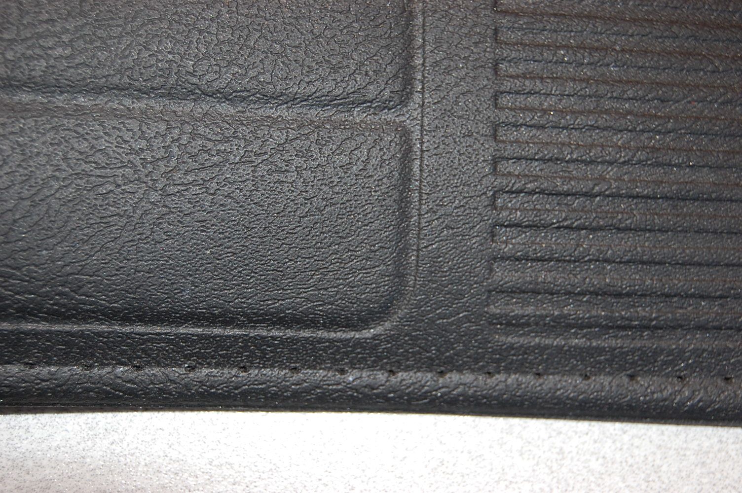

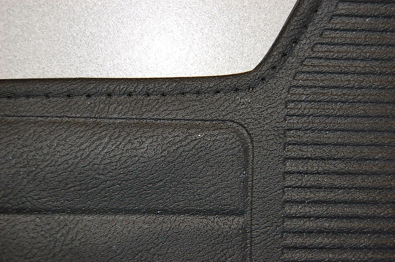

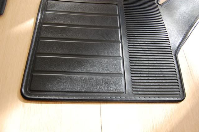

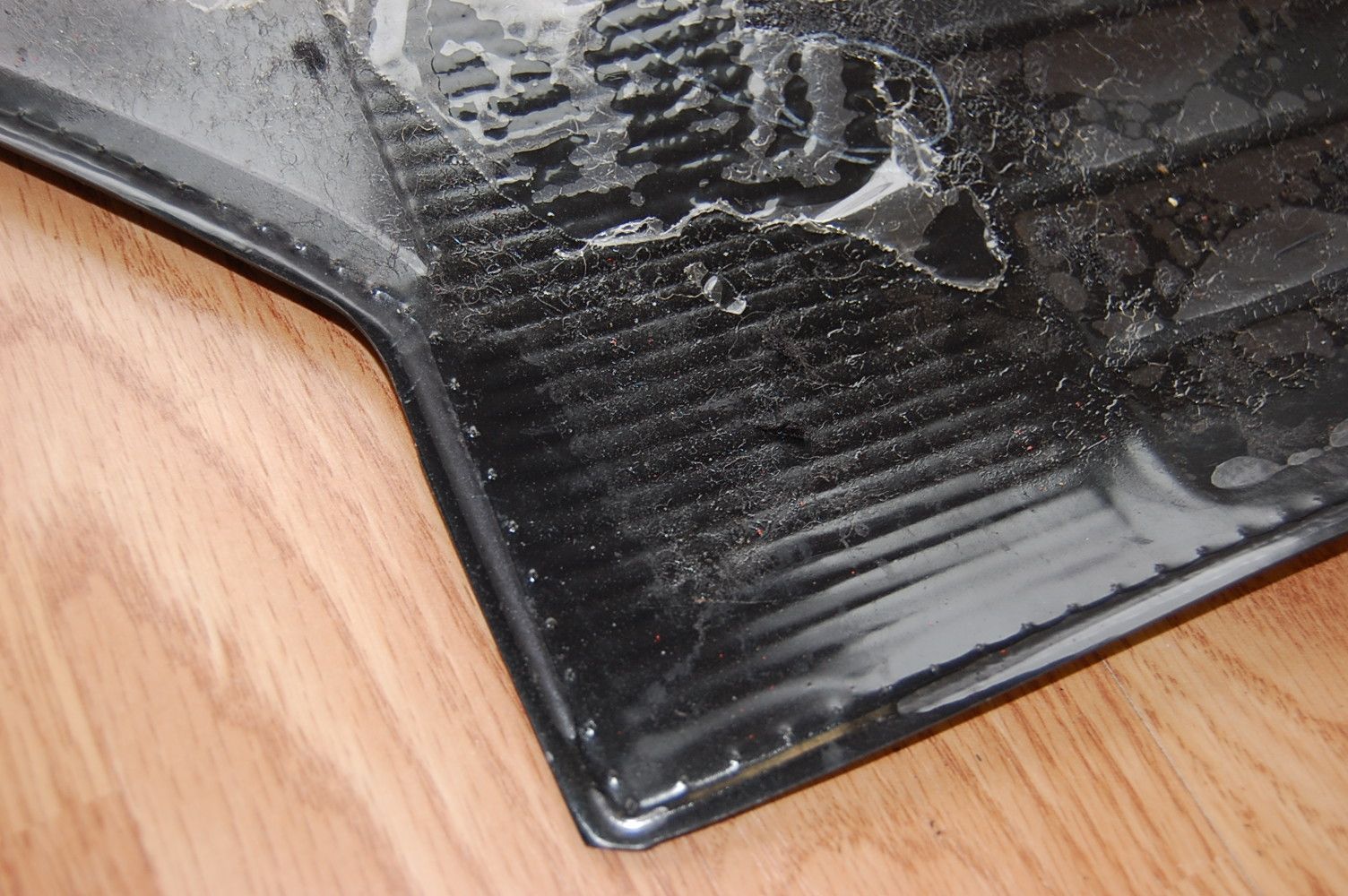

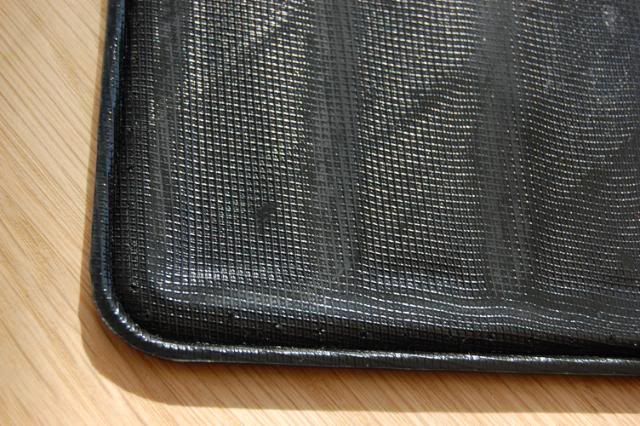

                            • 3416
                            Re: 1970 Heal Pad Al Knoch correct? corn roll ?
                            Hi Bob,
                            I posted pictures of an original heel pad and the Al Knock pads earlier in this post but deleted them because there seemed to be little interest in comparing them.
                            So I'll post them again.
                            Original heel pad.
                            Al Knock heel pad.
                            The elaborate construction of the ORIGINAL pad Don refers to.
                            Al Knock pad construction is unable to support neither the degree of detail nor the variations in the depth of the surfaces the original displays.

                              That said, I think Alan's limited area photos show the graining differences with Knoch's heel pad and an original very well. The Romeo IMCo logo is so large that most of the time I can see it standing outside the car. Original carpet has to be scrutinized very closely to find--especially it it black.
                              I do like the plush quality of Romeo's custom carpet--maybe it is a little too good. I bought a set from Knoch for my 1972 last year and it is nowhere as good as it used to be. My car is a driver, so in it went, but I don't like the look and feel.
                              It has been my experience with most reproduction parts that if one vendor does one thing correct, it will be wrong in some other aspect. When it comes to carpet, there is no perfect one at this point. One other aspect to be concerned about is the shape and binding on the rear bulkhead. That is one I deduct for 95% of the time.
