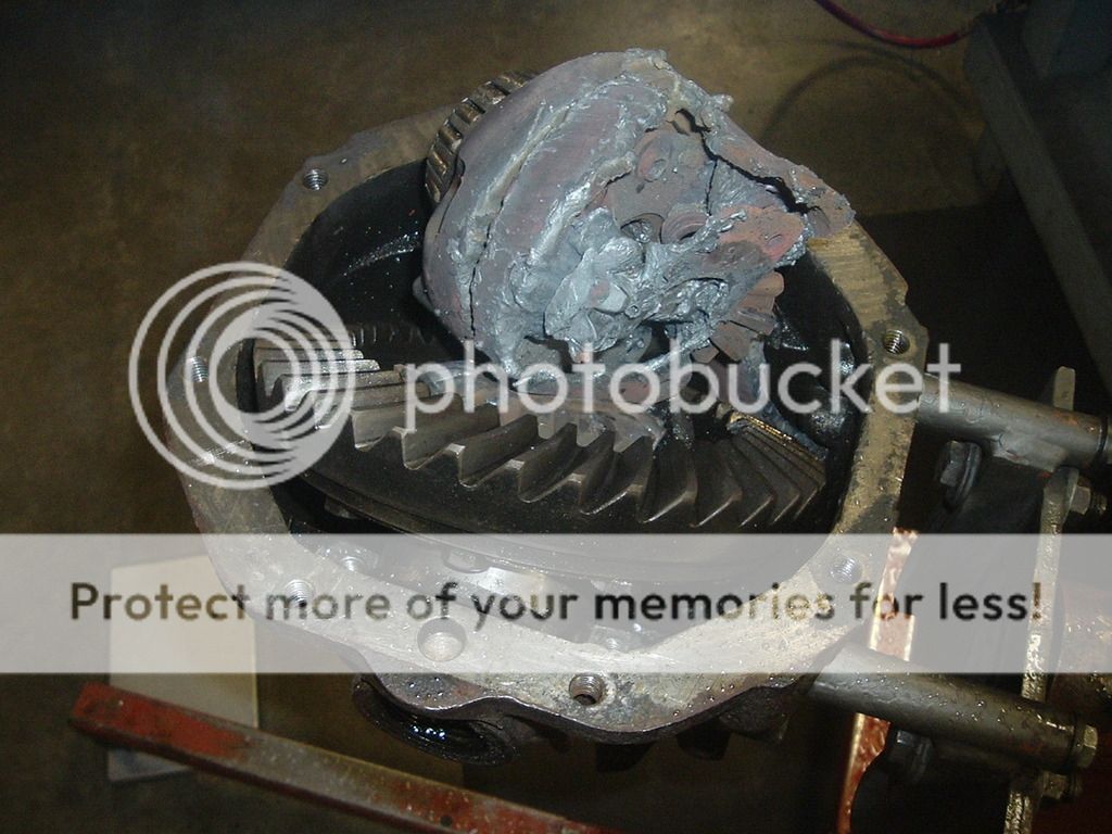

        My problem was the posi cracked and expanded into the pinion gear , pieces then jammed spider gears and just a few yards of movement of car sealed the faith of rear. I should have stopped driving the car, but I let my son drive it to hear the noise, he goosed the gas and bang!
        It happened in my driveway at less then 15 mph (long driveway)
        Jack

                        Jack had a 1968 complete differential in his '66 for the past 45 years. The '65-68's used the 1st design Eaton Posi case in place of the Dana posi used in 63-64. Keep in mind posi was optional until 1970 so there are some open differentials out there still. They were stronger then the Dana posi and I think equal to the Eaton 1st design.
                        The Eaton 1st design can be ID'd by looking at the case, they have what I call the "postage stamp" window in them. They were a parallel seam casting and this design was prone to cracking at the seam to large window opening. This casting are rough with sharp edges that are stress risers and with abuse or time the cracks form. Once a crack is started then it's a time bomb. Weld or drill repair does not work out well once a crack is there, the only solution is to replace the posi case with the better 2nd design Eaton case used from 1969 -1979 and still sold in the aftermarket today. The 2nd design can be ID'd again by the window, in this case a larger "tear-drop" window. These have a single staggered tooth seam and are much less prone to cracking but they still crack. When ever I build a diff I polish and tune the posi's to cut down on this from happening. I also have them cryo treated for HP applications.
                        In Jack's case the posi case developed a crack, who knows when, could have been in 1983 when Jack was burning rubber, could have been driving across the country, who knows. The only way you will know is to remove the diff and check it. However I have heard posi's getting ready to break by a clicking sound. I don't know if Jack heard that, I think he said he did when he came in last week but he would know better. My son heard it before his posi case broke in 1/2 on the street. Once the crack reached the cross shaft hole it was over. That is when I think it starts to click as play in the cross shaft and spider pinion gears increases. Then the gears will jam up and lock the posi and break. Jack's locked up and spun into the pinion "milling" it down in a second. Once the case broke it expanded inside the housing and really jammed up. It wrecked the RH axle and bearing and that is why I don't trust the housing. I have seen them break before but they usually shear and become loose parts inside the housing. Then when I open them up the parts fall out. Jack's was just the opposite. It was wedged so tight it was like having a case spreader on it and still wouldn't come out until I torched it out.

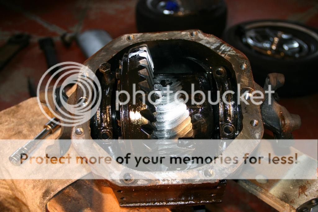

                              I made a quick ride to Easton, MA , where a good friend , Ed Johnson owns a home town service and repair shop .
                              Ed had graciously donated a late seventies corvette differential to my car. It has a 3:70 in it, but I will have that changed out (3:36) by Gary Ramadei, of New Haven , CT , who is going to rebuild and tune it for me.
                              I will box it up and send it to him this week.
                              Here are few pictures of Ed and his good friend Bob, (owns a 63) who helped with the transfer. If you ever need mechanical work done just south of Boston, give Ed a call....508-238-9455
                              Ed & Bob in his shop
                              Here she is .....

                                Looks a lot better than this one...
                                Here is the one that I blew up
                                Gary had to burn it out
