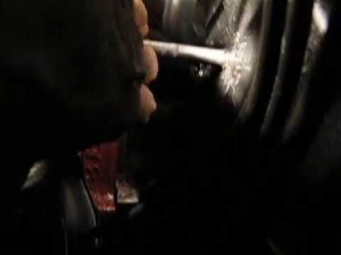

                  A while ago fellow member Frank Dreano's gorgeous '63 coupe was here for a little engine & engine bay freshening up. While I was in the bay I noticed one of his insulation fasteners was missing. It's the one right above the gas pedal area, where the insulation is doubled up and overlapped. The head was on the inside but the tip was missing in the bay. It was dry and broken up when I got it out. The tool worked good there, as the back of the cylinder head was up tight against the firewall.
                  Before removing the old broken pieces....
                  Dried out.....and view of the hole above the gas pedal.
                  Old and new. Soaped up the tip and inserted in tool.
                  Threaded into the hole from the inside, and after the "POP".
                  Here's a vid clip of the tool at work. It popped right in.....
                  I was hoping to have some made for the Winter Regional next week but I'm afraid it may not happen. I'll update when it happens.
