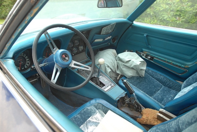

                Thanks, I'll keep you up to date. You have been very helpful. Did they put the same selection indicator on the console whether the car came with that option or not? This car and several 70's I saw at a show yesterday showed "AC" when in fact it it not have it. I have seen this in many cars of that era and wondered if true on the 70?

                    Without having a non-a/c control in front of me and reading from the judging guide it states that non-a/c '70-'72 Corvettes have the word AIR and DE-FOG on the control panel while the a/c Corvettes have A/C and BI-LEVEL. These units can be switched out. The things I look for in the interior are the two air levers with the black knobs on the shift console and no vents below the wiper switch bezel above the gauge console for non-a/c.

                              Re: That interior looks like my 69
                              This isn't a Maine car is it?
                              Back in the day when I owned my blue 69, I had the seats re-upholsterd with the blue velour.
                              Not original but the girls sure loved it!

                                Re: 1970 ZR1
                                Awesome info, Dan...Thank you very much.
                                Say...I think the same guy that did those seats also did mine!!! Crushed blue velour...Mmmmmm. You didn't buy that car in El Paso, did you?
