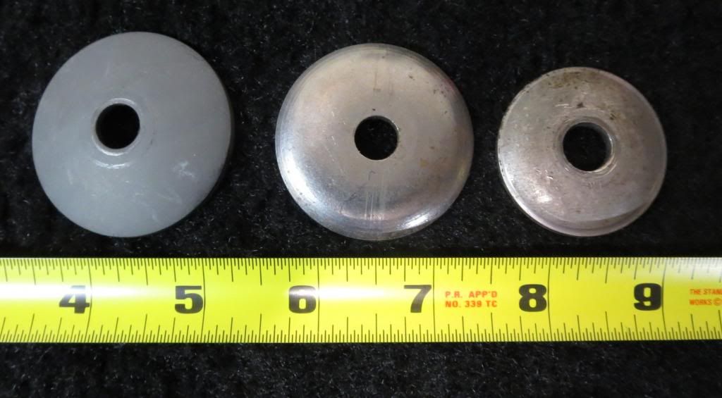

    Which is the correct washer/retainer for the front shock absorber? I have three different sizess in the parts bin. The correct part number is 3790342, but I don't know the dimensions.
    TIA,
    Mike

      Re: 1970 front shock absorber washer/retainer?
      Configuration looks like the one on the left, but I am hoping the distortion in shape (in the picture it looks oval to me) is due to the camera lens. Finish should be dark phosphate and oil. I am not sure if the center hole is the correct diameter again because of photo limitations.

        Mike------
        The one on the left.

              Hi Mike,
              I think your picture also illustrates the difference in 'arc' of the retainer for the front shock absorber bushing retainer (greater, and on the left), than the 'arc' in the retainers for the a-arm bushings (lesser, and in the center).
              The shock absorber retainer is on the right. 71 #6589

                Hi Mike,
                I have seen quite a few control arm retainer washers used in place of the shock washers.
