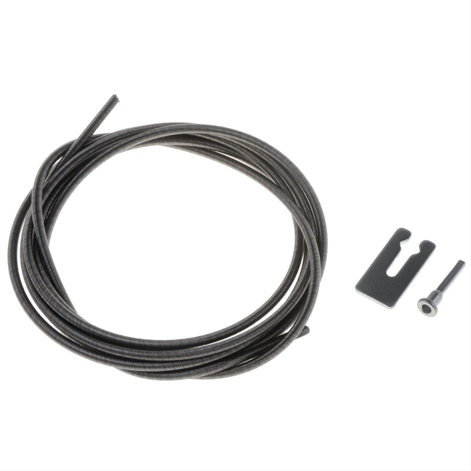

                        If Harry doesn't come up with one, here are some alternatives:
                        Free Shipping - Dorman Speedometer Cables with qualifying orders of $109. Shop Speedometer Cables at Summit Racing.
                        • Harry S.
                          • July 31, 2002
                          • 5245
                          Re: tach cable broke 67
                          Originally posted by Al Rains (13251)
                          Thanks Harry! let me know. It will be the weekend before I'll get a chance to get back on it anyway. Got to head back to Tn in the morning to work, and will be Fri getting back. Al
                          The kits that Jack pointed to are exactly the same, it would be easier to check them out first if there in your area. Also the prices are lower. Just remember that a small washer is needed so use the one that is there now don't discard it.
