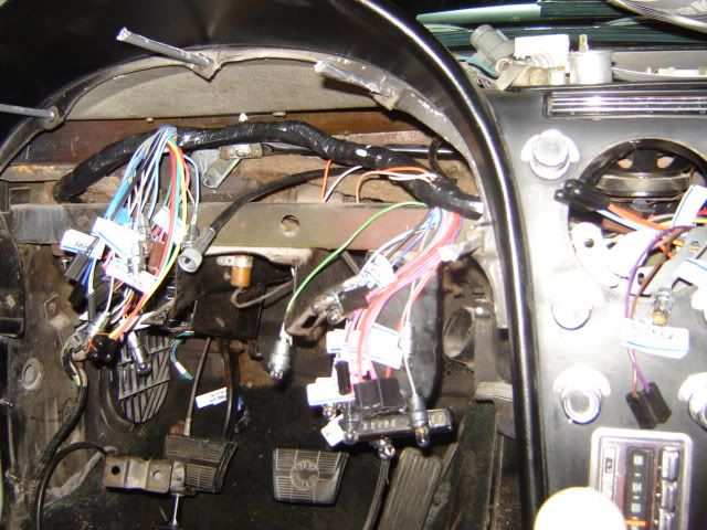

    Could someone post a photo of the right dash cluster tab on a C2 (where the screws holding the dash cluster screws into the clip)? Mine was broken off and I've built up some new fiber glass but I need to know how to cut of the glass to mimic what was originally there...

    Re: C2 Dash cluster tab
    Here's a couple from my 63 Coupe.
        thanks both for the photo's, that should get me going...

            I had the same problem. One tab was broken. I took a metal washer and placed it behind the broken tab so that the hole where the screw would go was close to correct (when the two were combined). I then scribed the washer at the point where the fiberglass had broken. Then I cut the washer and glassed it to the existing fiberglass tab (front and back). Finally, I drilled out the fiberglass and sanded it to match the other tabs. It worked great for me and I hope this helps.
            I have a couple of pictures, but have problems uploading pictures to our site. PM me and I'll be happy to send them to you.

              here is another one I received from Harry Sadlock:
