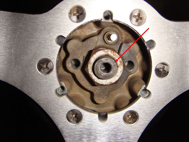

                  Yes, all 1967 and 68 GM passenger car steering columns came with a black plastic cover over the jacket mesh.
                  There is a notch machined through the splines on the lower end that attaches to the cast flange. That notch should be at 12 o'clock.
                  There should be an indentation on the very end of the shaft on the steering wheel end. That indentation should also be at 12 o'clock.
                  This picture isn't correct. But the red arrow is pointing directly to the indentation.
                  When you assemble the upper solid shaft to the lower tubular shaft, the notch and the indentation should both be at 12 o'clock.
                  Jim
