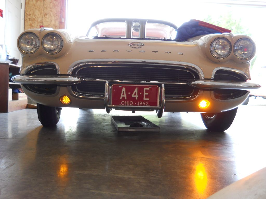

    The following link is a picture of my 62 Corvette with some new LED parking light assemblies.
    The parking lights are on and the left turn signal light is also on so you can see the difference in brightness.
    The sealed units have a clear lens with amber LED's.
    Point on the link and left click and it should open.

    Bruce, I converted the rear of my '65 a few years ago for safety. I have back up lights so only have 1 taillight instead of two and wanted the increased visibility. The biggest pain was installing the resistor so the turn signals would flash. Don H.

          I have learned that when I sell a set of LED tail lights I also need to sell a electronic flasher to eliminate the pain of installing load resistors.
          They are easy to install in C1's but obviously difficult in a C2.
          These only fit C1,s 58 to 62.

              Bright is better. Do these fit in original housings or are they a complete unit?
              Tom
              • Bruce B.
                • May 31, 1996
                • 2930
                Re: C1 LED parking/turn signal light assemblies.
                Tom,
                They are sealed units and fit in place of the bulb and glass lens.
                And they contain 25 amber LED's and are very bright.
