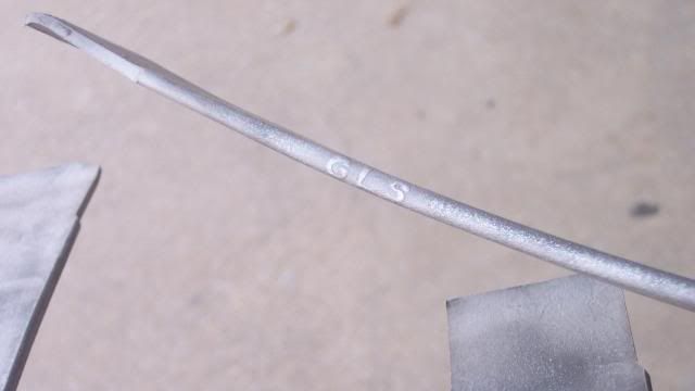

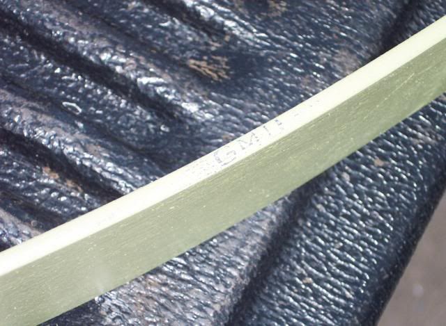

    A few weeks back was doing a restoration on a customers 9 leaf standard spring and reported finding some embossed letters 'GMU' on the sides of 2 to 3 leaves. I now have another customers 7 leaf F41 spring and doing a resto on it. Today I observed finding different letters 'GLS' embossed on the sides of 3 to 4 leaves. Interesting.......different manufacturer?

    The 3 alpha character embossings represent the supplier of the steel stock. "GLS"= Great Lakes Steel. I've forgotten what manufacturer that "GMU" represents.
