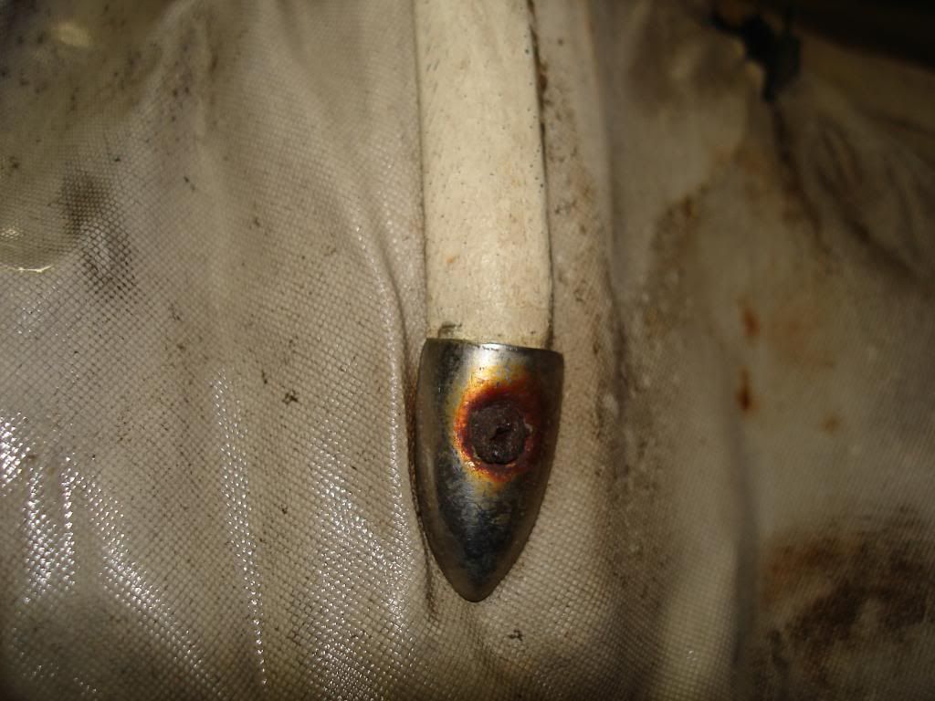

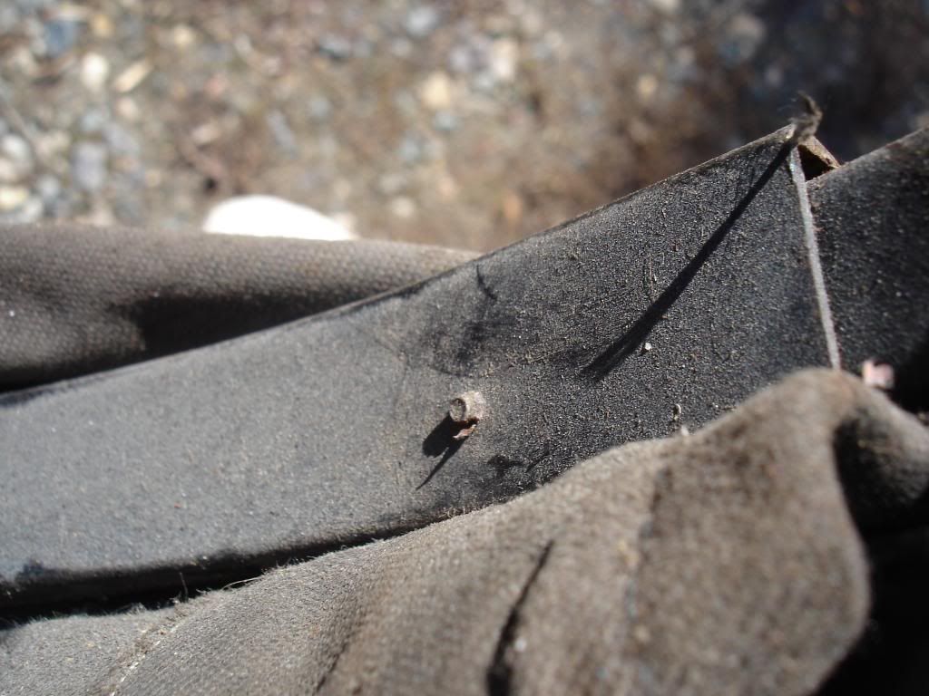

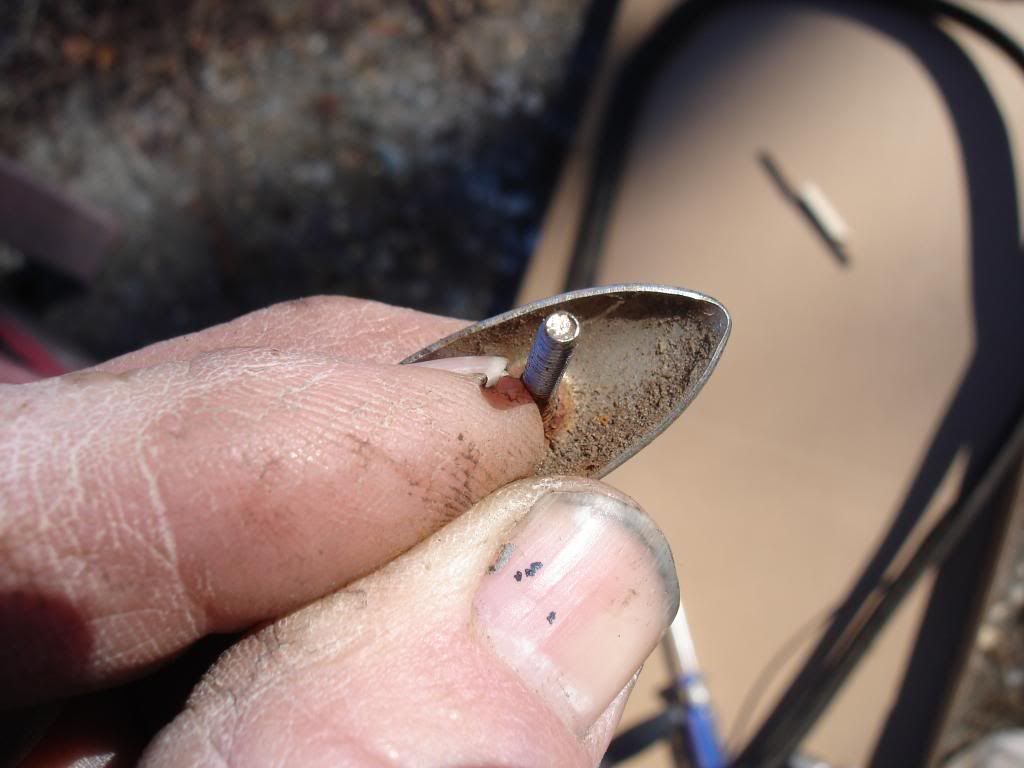

                    The caps pictured below are from a 63-67 Corvette convertible top assembly that I bought at Spring Carlisle in 1980 for $100. The vinyl top was no good but the frame assembly was in very good condition. I needed it because most of the tabs on the header on my original frame assembly were rusted and broken. I am not sure if these caps are original as each one was attached with small dome head nail. The caps measure 1.0" long, 0.66" in width at the widest part, and 0.25" in depth.
                    Dave
