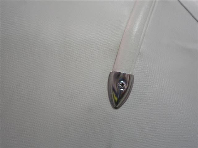

                          Ones on my 62.

                            Guys interesting post, My 63 conv. had the rounded tip spears installed as I thought they were original, when the car was judged I was told I needed the flanged tips.?????
                              I really doubt that many of the judges do serious research on every part of the car. Don't they just go "by the book"? Isn't that why we have this Technical Discussion?
