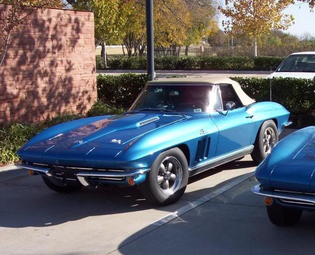

    I did a lot of research before I decided to purchase a set of American Torq Thrust D Wheels and radial tires to run for a while on my '67. I found a lot of information that was a bit confusing and old, so I thought that I would share my findings for anyone considering the same set up.
    As you know, the choices of 15 inch radial tires are just not what they used to be. I wanted a tire that had a "nice" looking sidewall and ended up choosing the BF Goodrich Advantage TA. The size is 215/70 x 15. That size is certainly pretty big but is close to the diameter of the reproduction 7.75 x 15 tires. I chose it over a 205/75 x 15 just due to the fact that I liked this particular tire better than the others.
    The wheels are American Racing Torq Thrust D Wheels in the 15 x 6 size (part number VN1055661). The car is stock ride height (327/300 - no AC), and there are no issues with clearance.
    I should also mention that I chose to paint the "spokes" a darker charcoal/gray color. I don't care for the original light gray color.
    I apologize for the pictures...they were taken quickly in "not the best" light.

    car looks great. but I think it would look better with a set of red lines or white lines

      The way Chevrolet should have built them

        Wow! That looks familiar.....

          I am running the exact same wheel on my '67....As for tires I am running 215/65 x 15 Falkin 512 radial....No rubbing issues and cars rides great........I purchased the wheels a few years ago.....I think now American is manuf in China.... Your car looks great.....enjoy.................P..

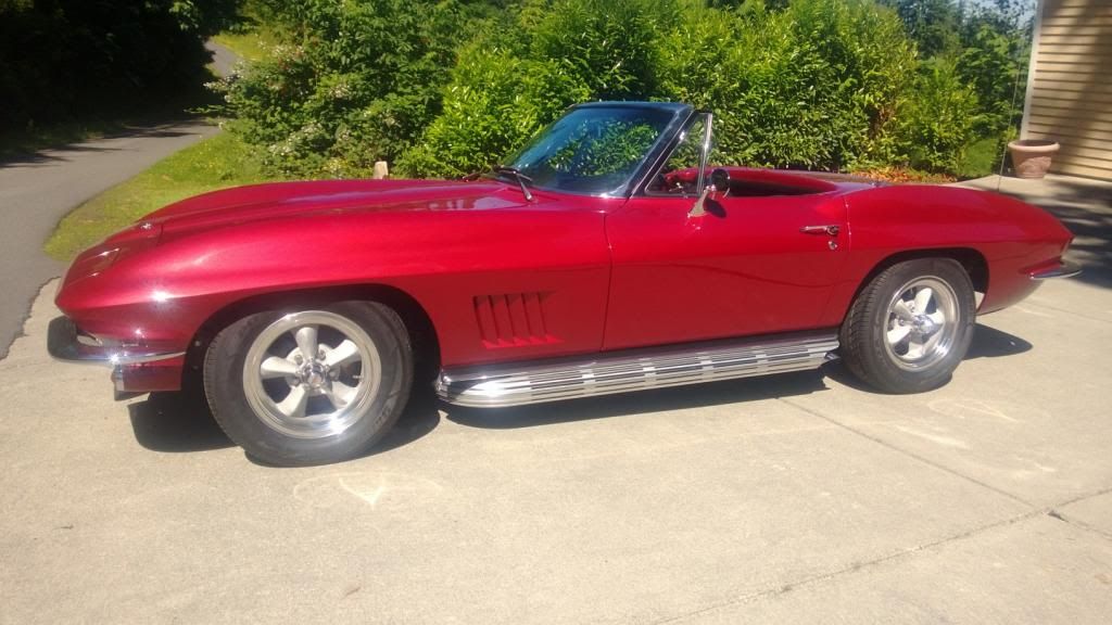

                          Hard to beat the look of ARs on our cars, here are some vintage 15x6 rims on my '67 with Bridgestone Pole Position 205/65/15s.
