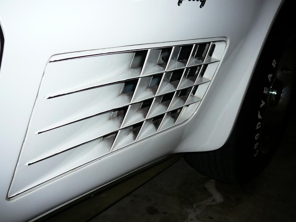

    A friend has a 70 LT-1 and is about to paint his side vents. For clarification, is it correct on the 70 that the egg crate side grilles only show chrome on the horizontal bars and not the vertical bars? I know there was a running change in 71, but from what I read after searching a bit, 70's were painted except for the horizontal surfaces. A picture might help.

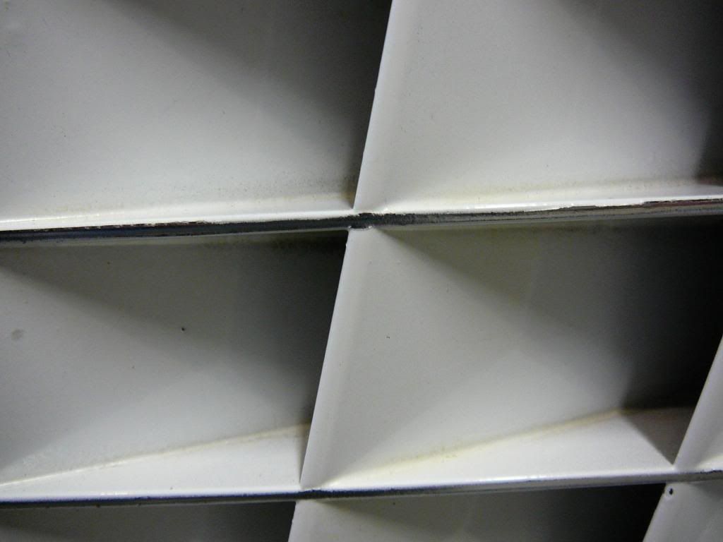

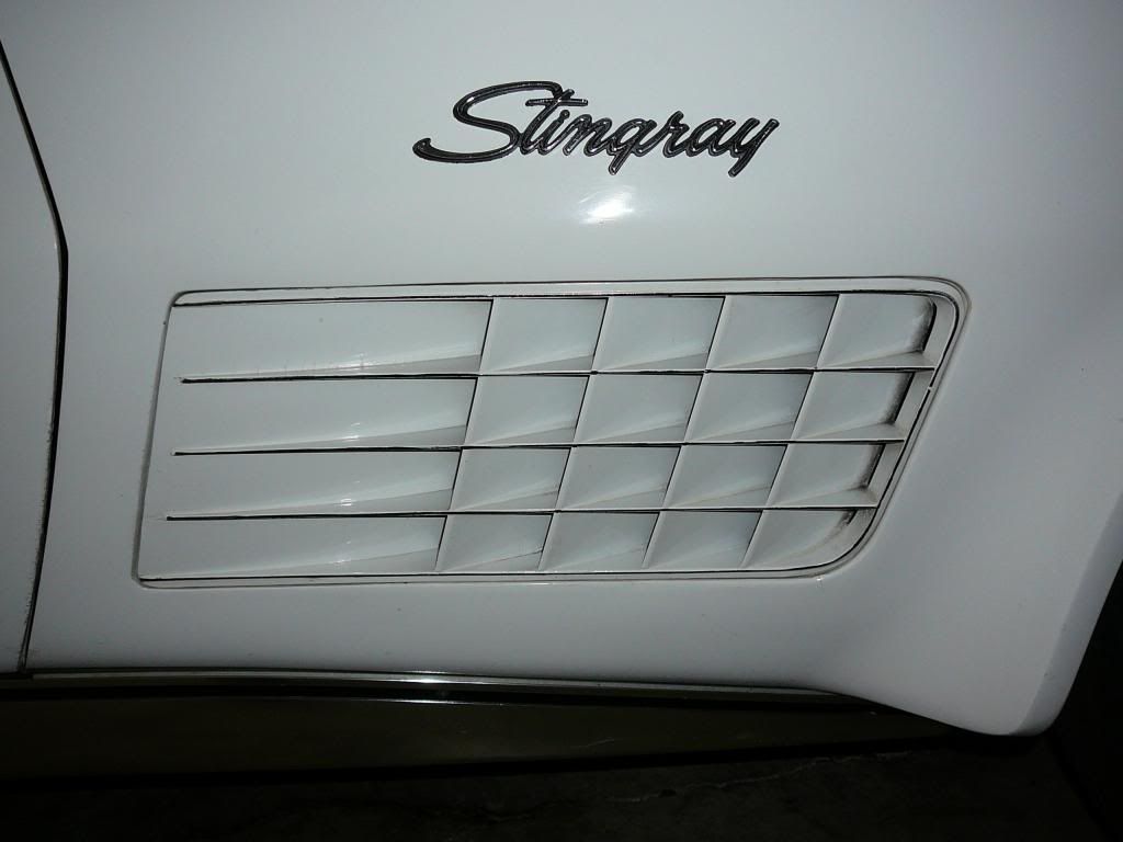

    You are correct, the 70's only show chrome on the horizontal bars (and the most forward vertical front edge of the grille). It's not just the paint though, the 70's vertical edges are somewhat knife edge, while 71-72 are more square edged.
    (The first photo appears like there is chrome on the verticals, these are just shadows. My verticals are plain white.)

      Thank you very much for your informative reply and the great, detailed pics. Exactly what I needed. I will send these pics on to my friend.

        The 1970 side grills do not have paint on the the vertical and horizontal trim. My own 71 LT-1, number 4,504 production date of 12/18/70 has one side with a 70 style and the other side with a 71 configuration. Note that inside the egg crates the paint is rough and has texture to it. Most restorations over polish this area.

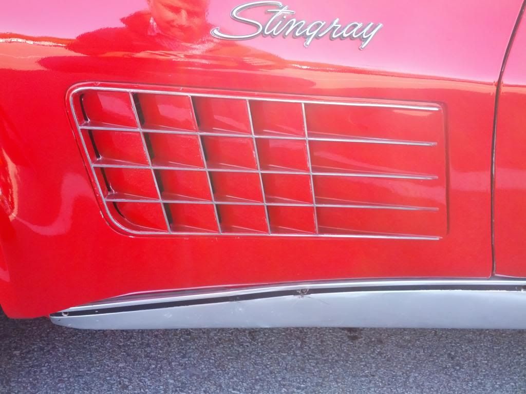

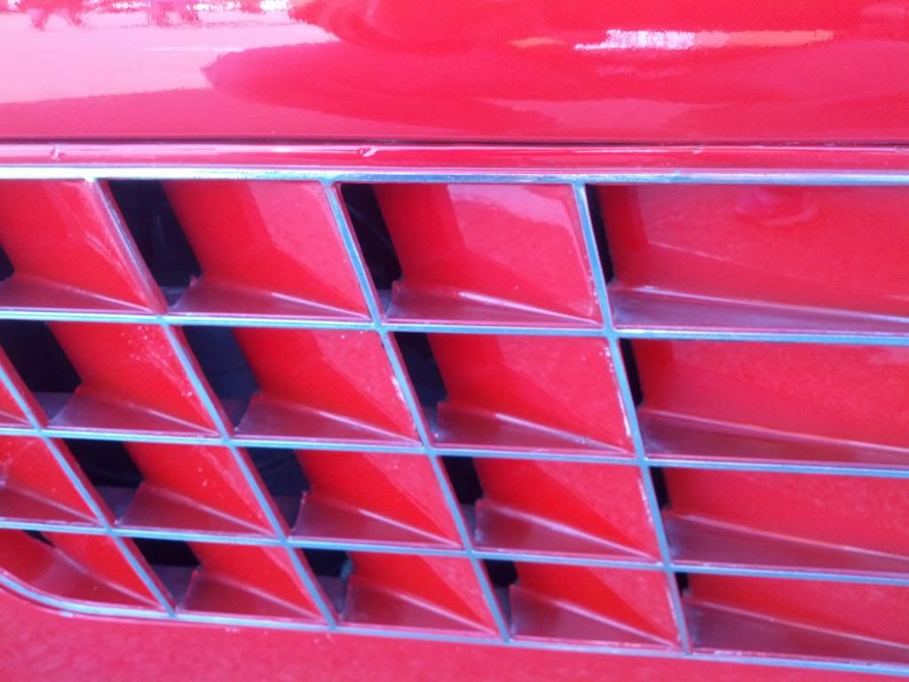

                72 for comparison.
