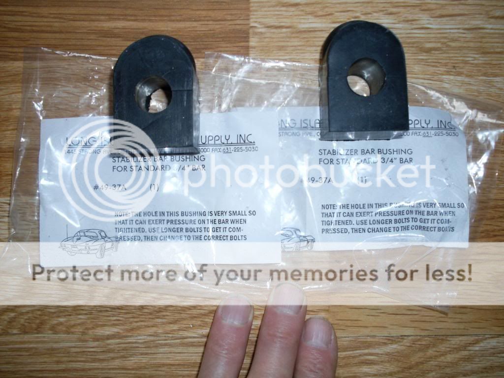

    I ordered the 2 inner rubber bushings for the sway bar on my 1964 coupe from Long Island
    I have always got the correct parts from them but what do you think of this bushings?
    I got the bushings in separate sealed bags and both bushings are identical
    Or will the rubber bushings press down enough in the bracket when put on the car?

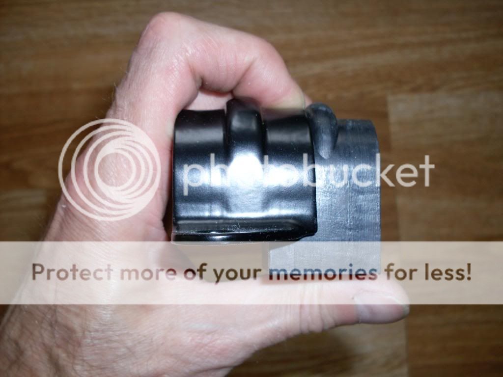

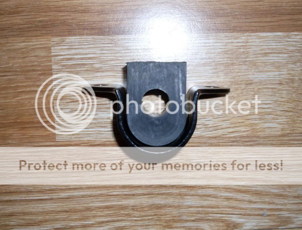

          Here is how the bushings compares to the bracket not using the "lip on the bushing

            You are correct, they are too long. I think I'd prefer the correct ones for a proper fit and function. Can you bid on US Ebay? One pair is $27.00, but shipping may be up etc.

              Both front sway 3/4" bar bushings came in closed plastic bags
              It would be strange if both bushings was labeled wrong dont you think?

                Claus, Install the ones you have. They ARE the correct ones. Follow the directions on the package and you'll be fine, your car will be fine and it will function and look just like when it was new.

                  Looks good Claus, if they are 1.75 inches without the rib, pack them in there! LICS is usually correct with their parts.
