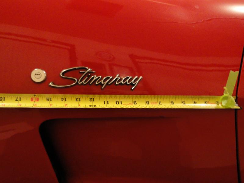

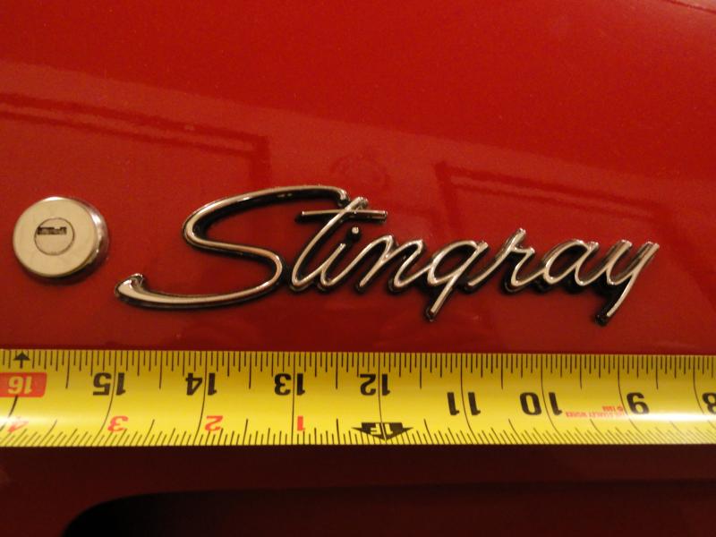

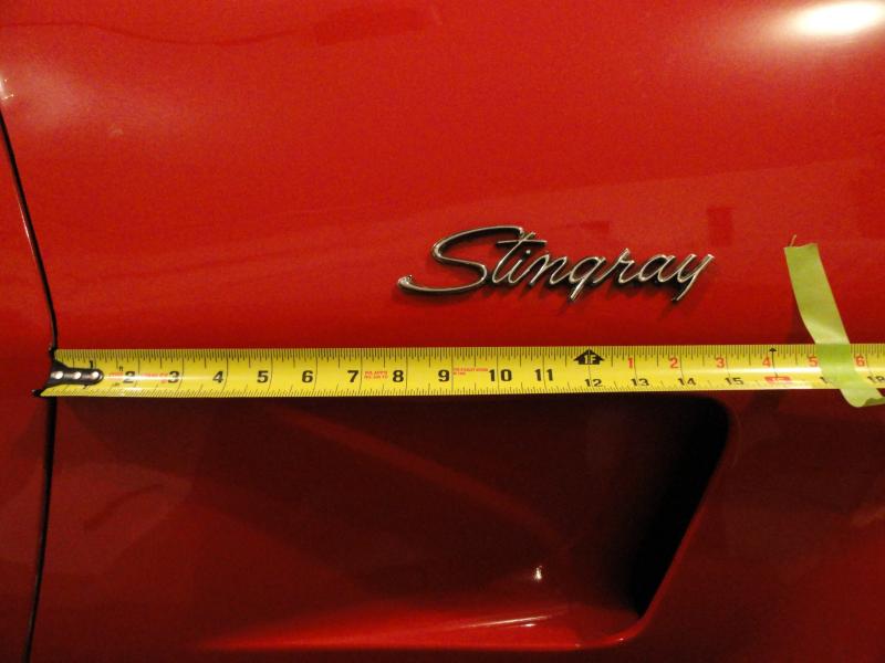

                From my 71. As far as I know, the front end glass is original but the car was painted (correct color) in the 80's. It is showing its age, but emblems should be in the right place.
                Pass side

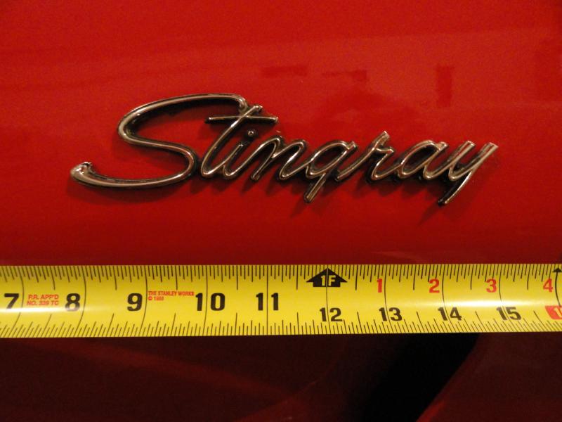

                  Re: Location of 71 Stingray emblems
                  Drivers side
                  It is hard to find any point of reference so I tried to reference everything from the top edge of the side vent.

                    So it's 2.5 inches from the "a" to the vent, and 5 inches on either side to the ends of the vent? Just making sure before I start drilling holes in my car!
