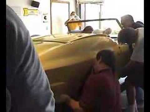

        Gary -
        Yup, 8 or 9 and a spotter works fine (this one is going back on, not coming off, but you get the picture).
        • Mike E.
          • June 24, 2012
          • 920
          Re: 67' lifting body off; how many men
          Gary -
          [ATTACH=CONFIG]45646[/ATTACH]
          Here's a video that goes along with that image from the Michigan Chapter's website.
          Mike
