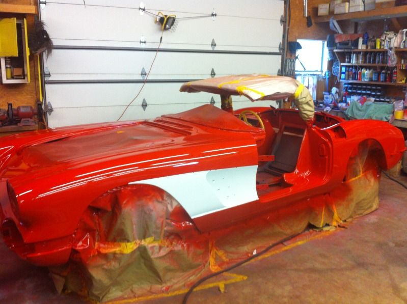

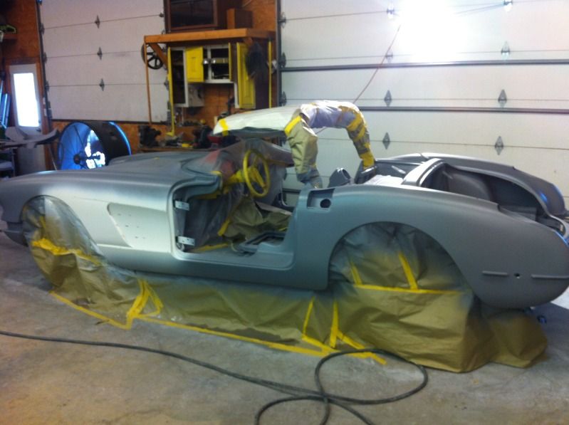

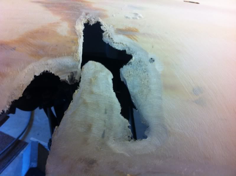

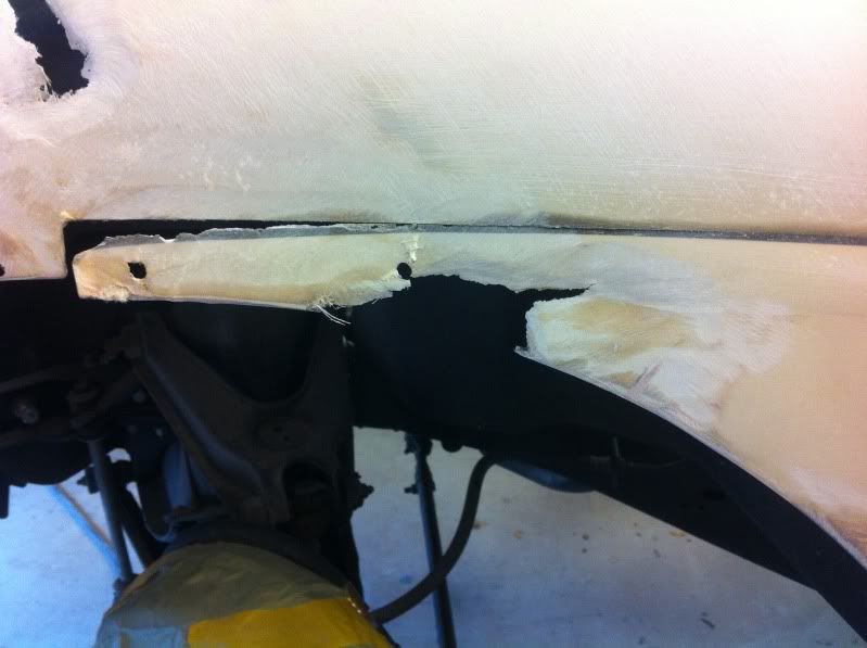

            Couple photos and short video:
            Click on image below for video---First time owner has driven his Vette since 2004!
            Here's a couple shots of what we started with:
            What broght the Vette to the shop in the first place

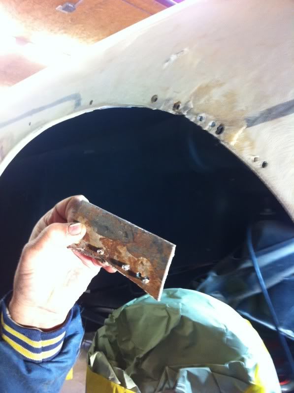

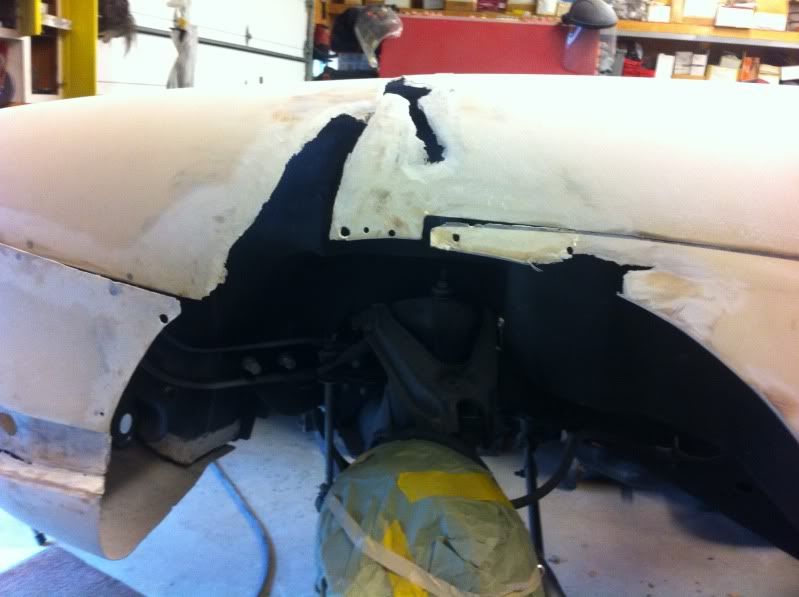

            Car was White, He wanted Red; Here's some of the things found after stripping the paint:

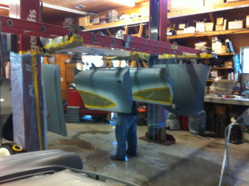

            Making progress:

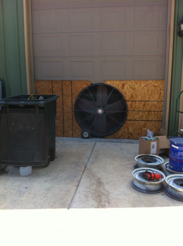

            "custom" paint booth exhaust system.

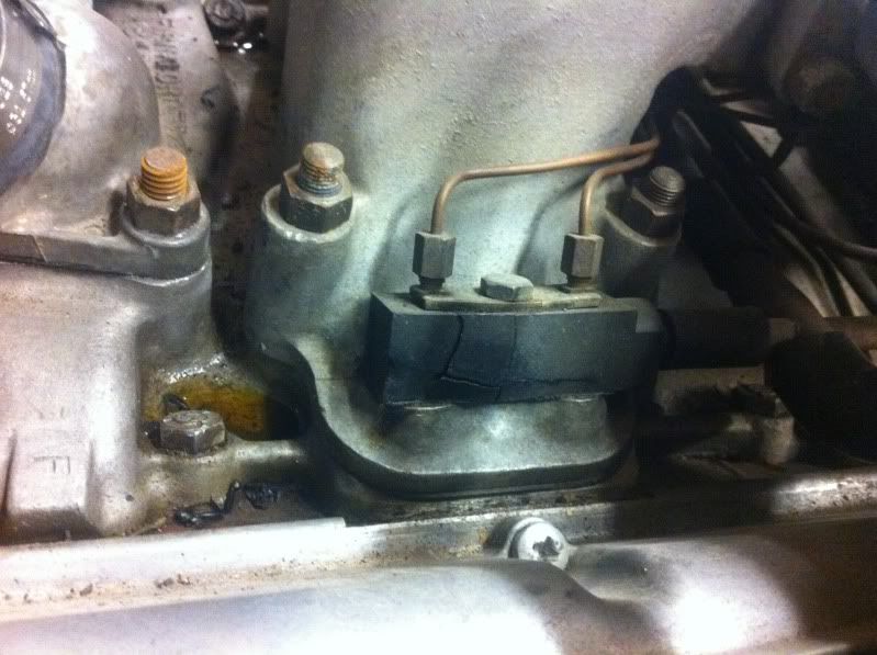

                  Notice Georges first photo showing a really broken/destroyed black plastic nozzle block. Reason it broke is quite evident. The 1/4" bolt that holds the nozzzles and nozzles blocks on is really cranked down.
                  You should be able to slip a business card in between the cadmium plated H shaped nozzle retainer and the black plastic nozzle block. Don't worry about how many thousands of an inch clearance. Just be able to see daylight between the center of the nozzle block and the steel retainer.
                  When you take the nozzle block off the H shaped retainer is bowed. When you go to re-assemble turn the bow up like you were a carpenter working with bowed lumber.
                  Last of all don't over tighten the nozzle blocks as the brass bottoms of the block will break/split.
