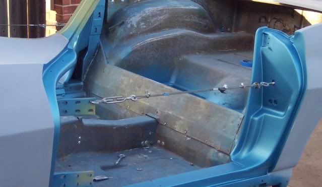

          Support of the rear portion of the car is a must on convertible. After removing the doors I made cabling (wire rope) that attach at the top hinge with a hook and the striker area with eyelet bolt. I used a turn buckel to adjust the tension. Have a look.

            I used the same technique, steel cable with eye bolt on both ends and a turnbuckle to tighten the cable. However it occurred to me that I didn't want there to be bending stress in either direction, so I cut a section of 2 x 2 and placed it between jambs at the top of the openings, then used the steel cable to "lock" the 2 x 2 in place. The 2x2 keeps the door opening from flexing in one direction and the cable keeps it from flexing in the other direction. Once the doors are off the only things connecting the front and back clips are the door sills. You don't want to crack them! I lifted the body with an engine hoist. The key seemed to be having a long enough reach to place the hook over the center of the body. I used nylon rope and attached it to the front corners at the radiator support, at the center to the corners of the windshield frame (glass out), and at the rear around the spring towers for the deck lid. I let the rope slide in the hoist hook so that the tension at each point was equal. I built the dolly according to plans I found on this forum. The only problem was that I wished I had made the body mount higher to make it easier to get under the dolly. After getting the body off and fastened to the dolly I attached 2" aluminum "U" channel as outriggers at the front and back ends of the dolly. They extended out from the dolly by ~6 ft on one side and 2 ft on the opposite side. I then attached steel angle vertically to the 2 ft end and attached another piece of angle from the top of the vertical piece, across the body to the "U" channel. This created two triangles. I could then lift on the 6' extended end of the channel and rotate the body and dolly 90 degrees. That allowed me to have full access to the underside of the body so I could clean it without laying on my back with stripper and lacquer thinner dripping in my face.
