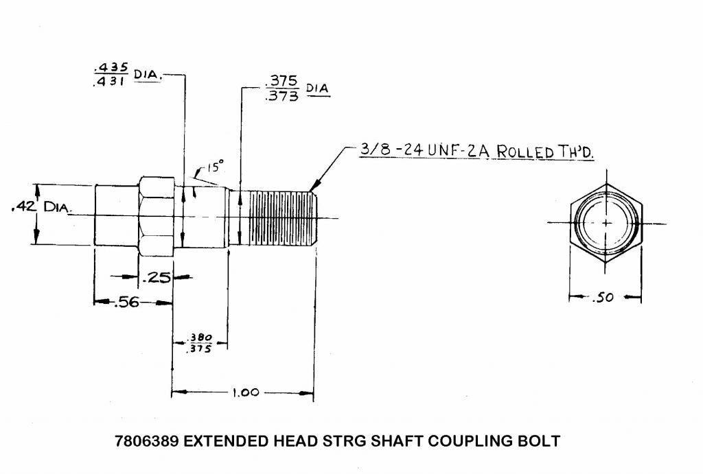

                    Sorry, I can't help you on availability. I am wondering how particular you want to be in noting the differences between the 5699250 and the 7806391 cplg assemblies. The major difference is that the ..6391 assembly had extended head bolts.
                    These bolts were introduced on strg shaft cplg asms that were used with energy absorbing steering columns.
                    It is very difficult to track the flex coupling changes that occurred from 1967 SOP thru the early 1970s for this reason. In 1967 General Motors introduced energy absorbing steering columns. Up until that time, the steering column steering shaft was just one solid shaft from steering wheel to the flex coupling on the steering gear. So there was virtually no concern about the shaft moving. With the introduction of the energy absorbing steering column, the steering shaft was now in two pieces and could telescope on itself. Any motion of the body to the frame could cause the shaft to foreshorten. Now when the body and frame motion relaxed, the flex coupling asm could be pulled apart. This was a new dynamic and required several rapid design changes.
                    The extended head bolts were added to help insure that the heads of the bolts would make metal to metal contact with the bow tie flange even if the coupling assembly was somewhat pulled apart.
                    Both coupling assemblies had bow tie flanges (gear input shaft flanges) that had full round splines. So neither of these assemblies would assemble to a Corvette gear with a flat on the input shaft (mid 1969 and later).

                      I believe they are now both obsolete, the #91 being last available about 2-3 years ago and it was not grounded. It had yellow ink on it.
                      Jim that bolt print looks like one of my old trade school assignments for lathe work!
