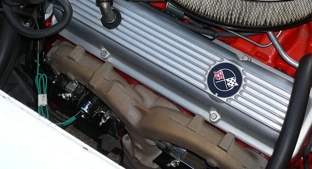

                • Mike F.
                  • April 25, 2011
                  • 668
                  Re: Ceramic coat exhaust
                  I had my manifolds flame sprayed with aluminum here - http://www.z28camaro.com/restosvcs.html#manifold
                  and then sprayed painted with VHT paint.

                    • Roger G.
                      • October 11, 2012
                      • 268
                      That looks really good. Have you noticed a drop in temp? Have they been judged?

                          • Mike F.
                            • April 25, 2011
                            • 668
                            Have no idea on the temps. Never gave it much thought. Judged by me as awesome, not judged by NCRS.
