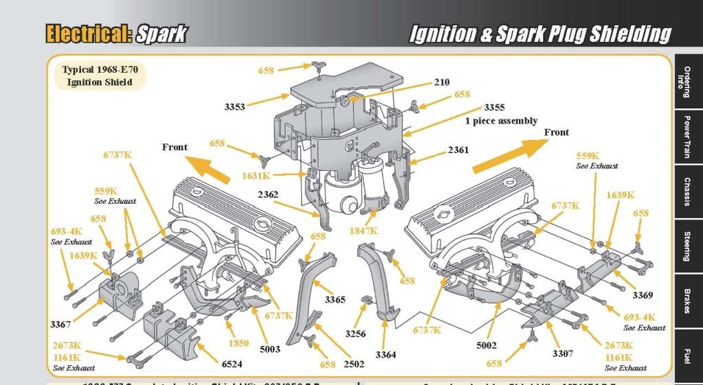

            The longer shield goes on the rear passenger side, the hole is for the TCS temp sending wire.
            The shorter one goes on the front driver side, the hole is for the in car Temperature Gauge sending wire. This one is a huge pain in the a$$ to install. Here's what I've done in the past. Swearing is a must! (It's easier to install if the alternator is removed. You'll see)
            1. While holding the heatshield - attach the aft bracket to the heatshield with the wingnut (leave it a bit loose).
            2. Install the forward exhaust manifold bolt with forward heatshield bracket (leave it loose).
            3. While holding the heatshield close to being in place, fish the temp sending wire thru and attach to sending unit.
            4. Final fit the heatshield in place, align aft bracket and install center manifold bolt. The fun part is having everything loose and moving all at the same time.
            Good luck.
            Here's a pic from the Paragon catalogue, the aft passenger side shielding is not accurate due to lack of TCS wire hole.
