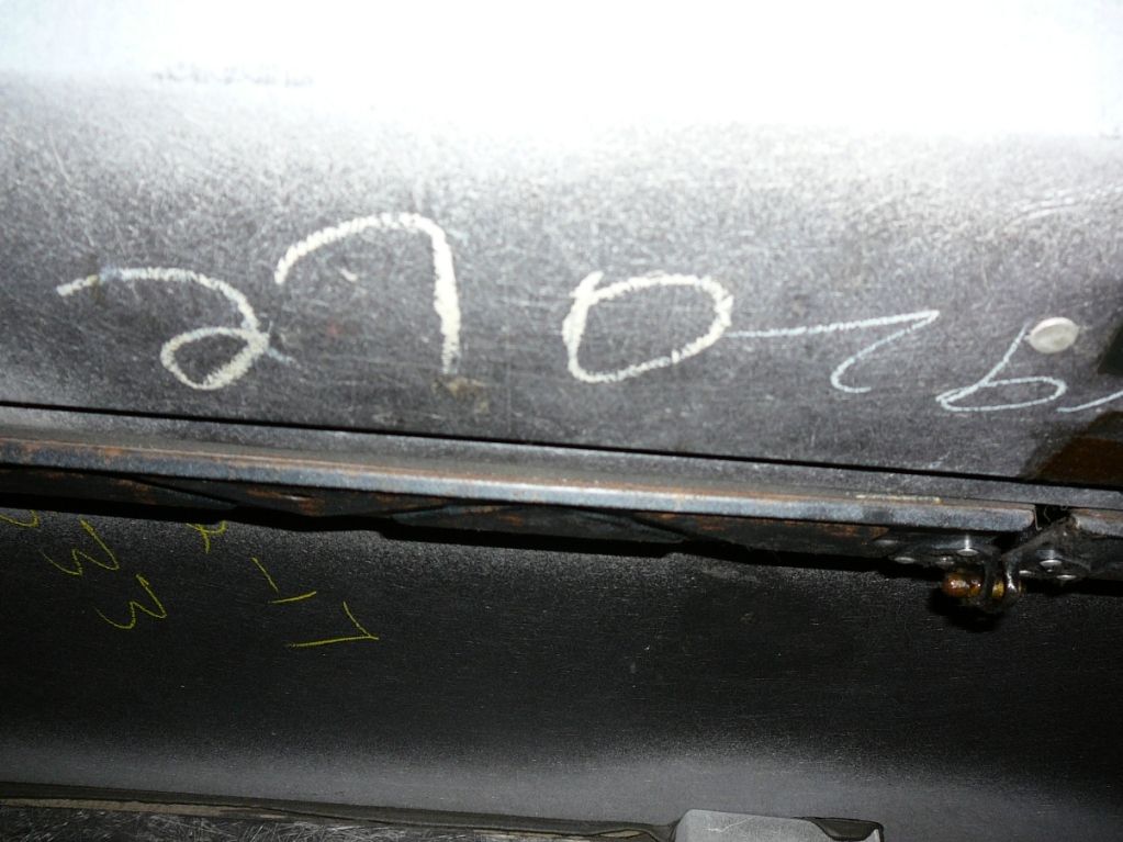

    My 70 Coupe job number is 270 and my VIN is xxx516. Can someone explain the math to me? I thought it went in increments of 500.

    Correct, but there is no distinct correlation. Any relationship between them is generally coincidence.
