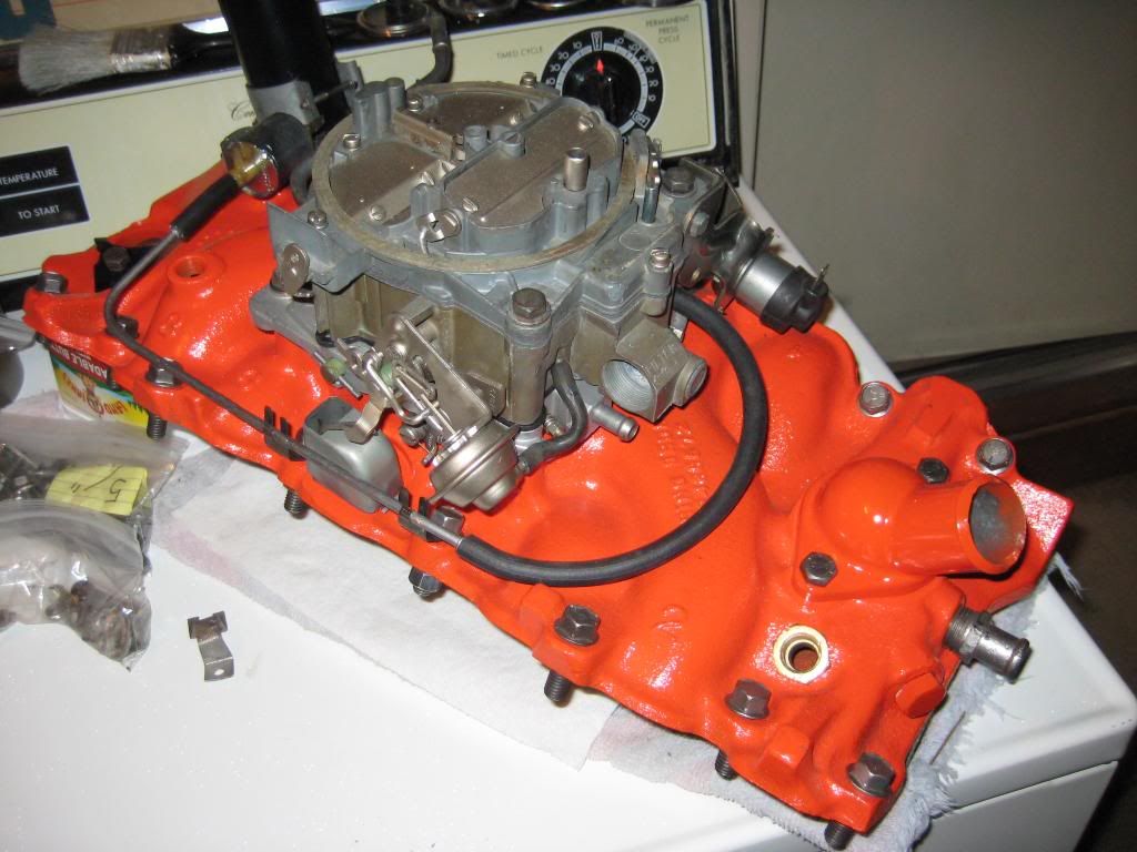

                    Just as I got started on thismess, I was just getting my 72, LS-5 in order. The guy that bought it wanted an LS-6. He could not get one. So, after driving the car for a year, he took it a part.
                    He ordered everything over the counter to make it an LS-6. Even the heads. When I bought the car in the 80's, I got all the original parts with it. So, I was just gettingmy intake in order on that car. Built the carb, put the TCS, dug up a set of original bolts and so on. A few things are not exactly correct, but they will have to do until I can find the little things missing.
                    I just thought you might like to see the other project.
                    Monte
