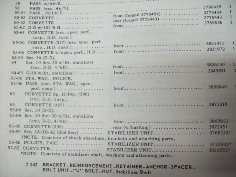

                            Re: Questions about secondary front sway bar for early Vettes.
                            It's listed (bottom listing, group 7.241) here in my 66 parts book.
                              I think it showed up in the parts book then. It was available earlier than that to the right people, because Gulf, et. al had them at Sebring. It was also already announced in Corvette News vol. 5 no. 3.
