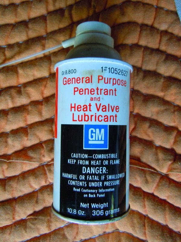

      Hi Jack,
      If you can find this product, it's specifically made for just your problem.
