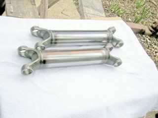

              well I had Quanta do my half shafts, not for judging though and they did a nice over the top restoration.as JH said they almost had a chrome like finish so I decided to do my drive shaft myself. then I reworked the half shalfs.... here are a few photos

                They way over polish the shafts plus if you are unfortunate to own a 72 BB car, they will flaten out the "gator" roughness of the shafts.
                Having said this ..
                you can use the service to get a great starting point. Then take gray scotch-brite and rub the shine away and get the dull looking finish it should be.
                You can emulate the shot peening somewhat.
                Botom line, you get a deduct on finish using the service ...
