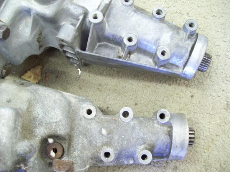

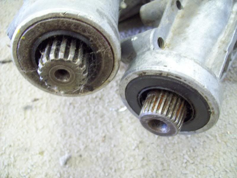

                    Within a fraction of an inch, the B-W T10 and the 63-70 Muncie are the same length (71-74 Muncies, as well as Super T10s, are 3/4in longer than the 63-70 Muncie). Thus, T10s and Muncies are completely interchangeable, with the exception, as already mentioned, the difference in tailshaft splines, 16splines for the T10 and 27splines for the Muncie (and all 63-later tranny tail shafts--------------except the larger, 32splines of the Turbbo 400, 71-74 Muncie and Super T10).
                    Compared below is the 16splines of the T10 (as well as 62-earlier 3spds and PGs) and 27 splines of the Muncie.

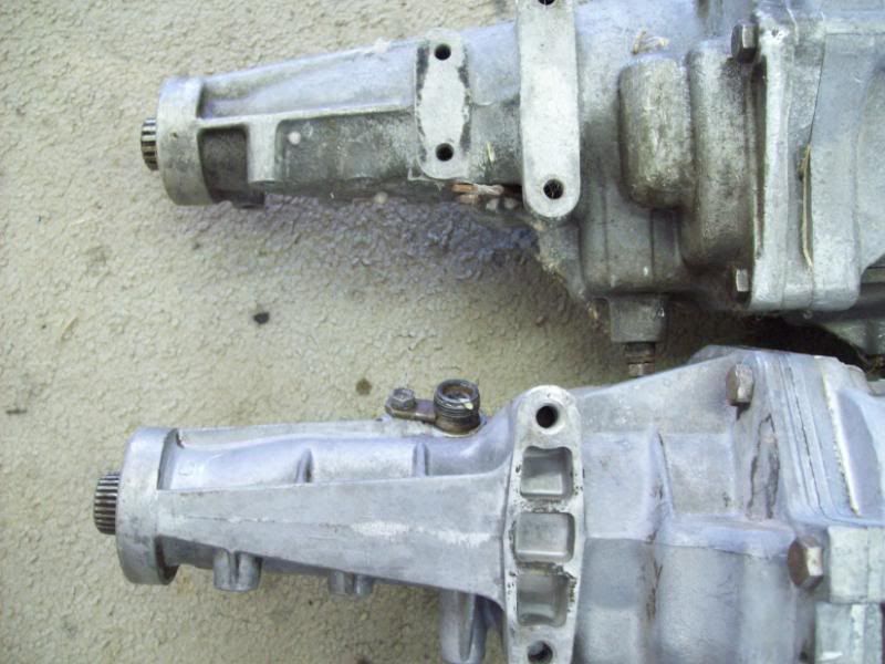

                    The EARLY T10s only had the tranny mount shown by the pencil. The later T10s had the longer mount added (first required for pass cars). This longer mount was first used on a Corvette in 62, and it required an adapter plate. The adapter plate is available from all of the Vette vendors (about $20) and is required for swapping a Muncie for the T10 (or 3sp) in a 56-61 Vette.
                    As can be seen here, the long mount on the later T10s (top) is in the same location as the mount on Muncies.
                    This shows the adapter plate used ONLY on 62 Vettes with a 4sp. Use this plate to install a Muncie in a 55-61 Vette.
                    Also, notice the longer, later mount extends about 5/8in lower than the earlier, shorter mount. Thus, a spacer needs to be installed BETWEEN the X-member of the frame and the tranny cross member (when installing a Muncie). For the 62 Vettes, there were factory installed spacers at this location which were about 1/8in thick. In my opinion, THIS IS NOT ENOUGH! On my 56 I have used 1in square tubing to space the tranny cross member down.
                    The Muncie tail housing (top) and the later B-W T10 tail housings have the shifter mount holes in the same location. BUUUUUUUUUUUUUUT, T10 and Muncie shifter plates and linkage are different from each other.
