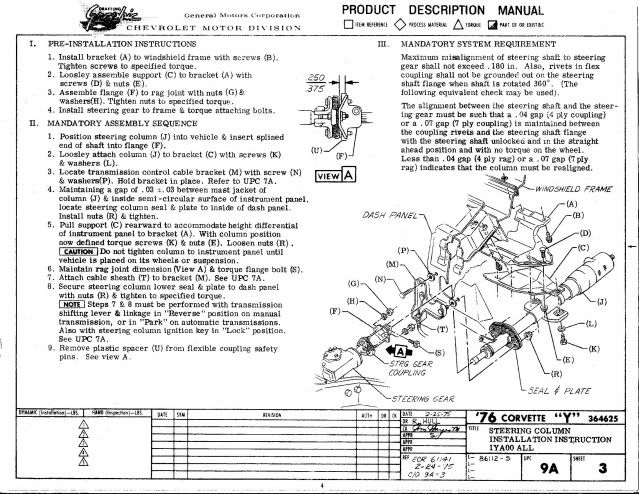

    One other area that you might investigate. Your 1967 Vette has the steering column that mounts directly to the steering gear through the flexible coupling assembly. It is very important that the steering column be aligned precisely to the steering gear. Note, the gear is hard mounted to the frame so there is no adjustment available at the gear. All of the adjustment has to occur with the column mounting.
    The AIM and the Chevrolet shop manuals have some very specific instructions as to aligning the column to the gear.
    You should be able to inspect your connection and determine if your stop pins are central to the cutouts in the column flange. Then rotate your steering wheel 1/4 turn and determine that your pins are still central. If you always find equal clearances, then you can be fairly sure that the column is aligned to the gear.
