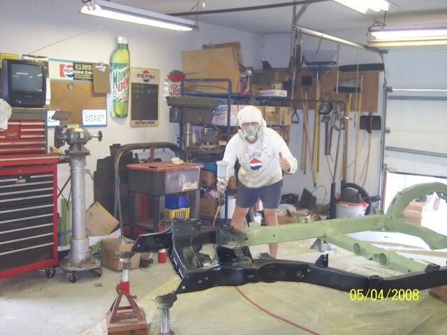

    No powder coating if your having the car judged. After having my frame stripped shot self-etching primer on it, then low sheen chassis black.

        Unsure of this rational as IMO an unneeded process and expense. I've done numerous frames using the aformentioned process....still look good 15+ years later.
