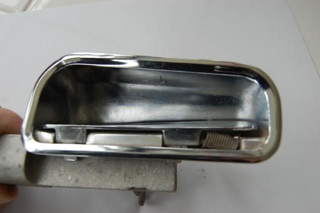

                Paul/Alan, it appears the bowls have been painted, but the bowls do have a distinct 1/8" of polished chrome on the vertical surfaces. The finish under the paint looks like polished chrome and I am therefore concluding they are service replcements or repo's.Question: I assume on a correct original handle the entire bowl is then a non-buffed chrome finish. Correct?Attached are a couple pix's

                    • 3422
                    Re: 1972 door handle finish (inside)
                    Hi Jerry,
                    For some reason I'm unable to open your attachment.
                    Here's a picture of the chrome finish on one of the handles from my 71, (46k).
                    The 'lip' is polished and brite, but the entire bowl is unpolished to my eye.
                      Hopefully this will worK.
                      I think under the frosted area of the bowl will be polished chrome and not the unpolished like yours.
                        Jerome, I had a set of GM handles that had the satin finish inside and after the removel of the paint its just like a flash chrome on the inside of handles.
