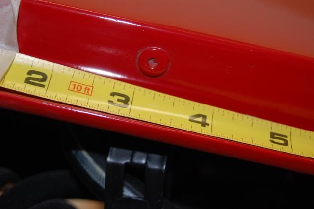

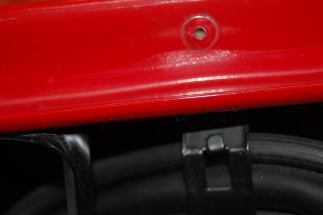

            Do you think they're aluminum? Also,would it be possible to get the diameter of the head? Thanks!
              • 3416
              Re: '72 Vacuum hose clips
              Hi Lynn,
              Here are the originals from my 71. The car's been painted, but they are the originals.
              I'd say the head measures 3/8", and the rivets appear to be aluminium to me.
              Left Side
              Right Side
