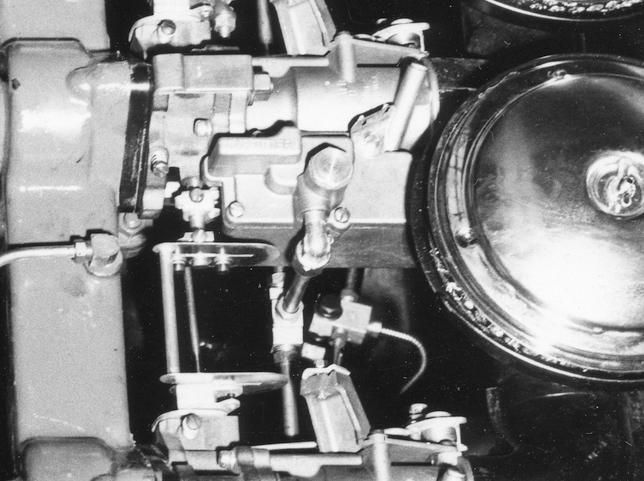

    That fitting on my unrestored #3300 is a simple inverted flare fitting, common as dirt:

          It is a plain, readily available inverted flare fitting, sold at any NAPA store. It looks like this:
          The middle and front carburetors use an archaic form of compression fitting, not readily available. If Mary Jo or Grossmeullers still sells them, then problem solved. In any event, this is what you want:

                    Brad, the pictures I posted early in this thread (color of #3300 and B/W from GM) are of the fittings you want.
                    The rear carburetor takes a 90 degree, 5/16 inverted flare to 1/8" pipe fitting..... sold everywhere fine autoparts are sold.
                    The middle and front carburetors take an archaic 90 degree compression fitting.... apparently available from Mary Jo and Grossmeullers.
                    Is that now more clear?

                        You'll notice the old GM photos show exactly the same fitting arrangement that is on my unrestored #3300 '54.
